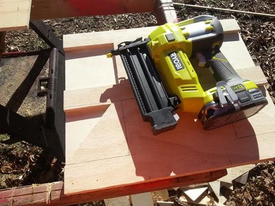

forgot to snap a lot of pics, but I did remember to get one of the new cordless nailer which has won me over.

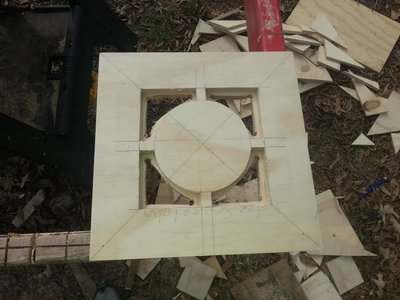

I used it to tack the template for the horn tops and bottoms onto the blanks (precut to size and edge bevels) so I could use a pattern bit and router. note: the pile of rubbish directly under the last piece about to be cut. That is the scraps from the seven pieces cut prior to the pic. Made quick work of the eight pieces necessary. I was going to clamp everything, but the nailer is just soooo damned handy. Plus, the holes are easily filled. The brad nailer has run 6 sleeves of 1.5" 18ga. brads and still shows 3 out of 4 lights on the battery gauge. It is fairly fast (~1 brad/second) and seems more accurate on depth than my old bostitch air gun. No jams yet... but only 6 sleeves in, still lots to go before I say it's reliable and jam free.

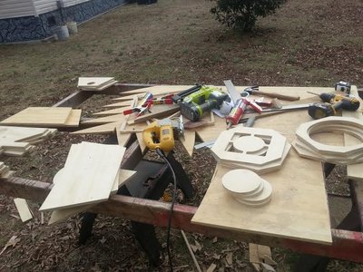

Working outside is taking a huge toll on my organizational process. It's nice to work in the sun, but I miss having some workbench area, some shelves, and some options when it comes to setting up for a cut.

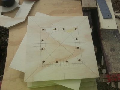

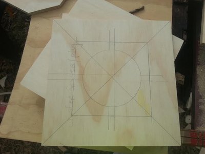

Today, I used the template/pattern bit method to bang out the baffles, spacers, and phase plug extension Except for the mess, it went pretty good.
