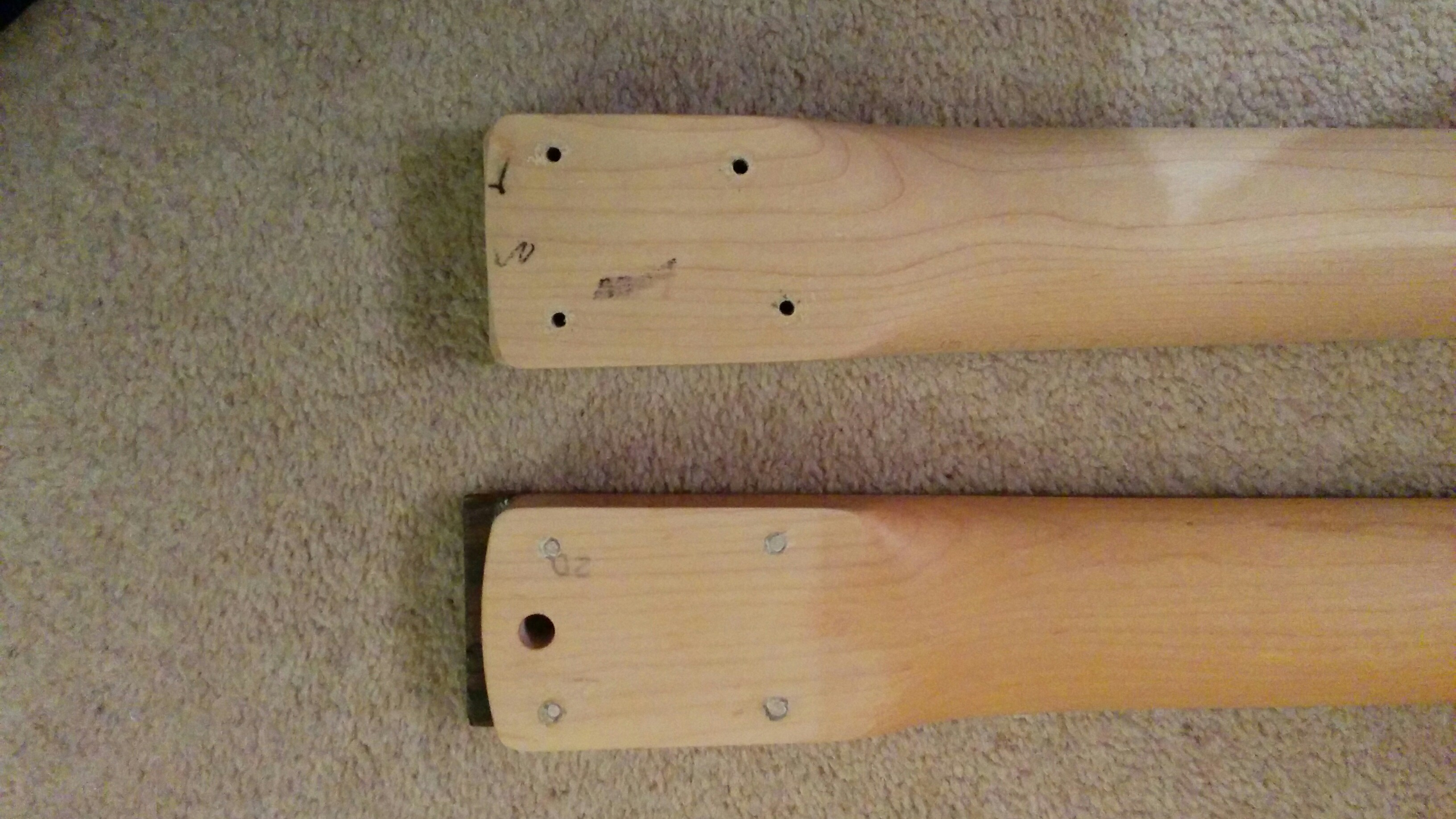

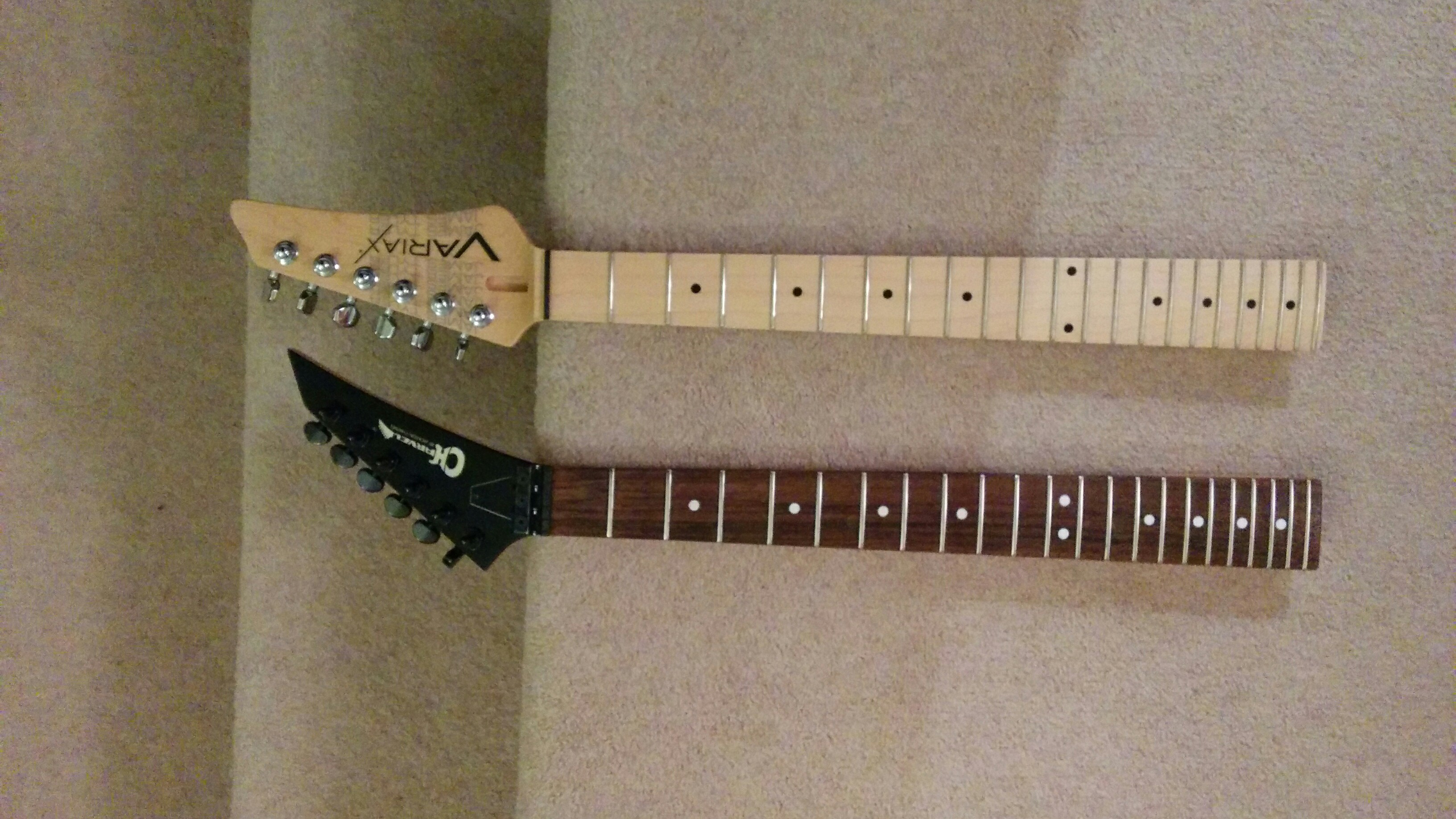

I purchased on eBay an 80's Charvel neck with the same 25.5" length and heel width. The profile of the heel is slightly different though, so what is the best way of copying the profile?

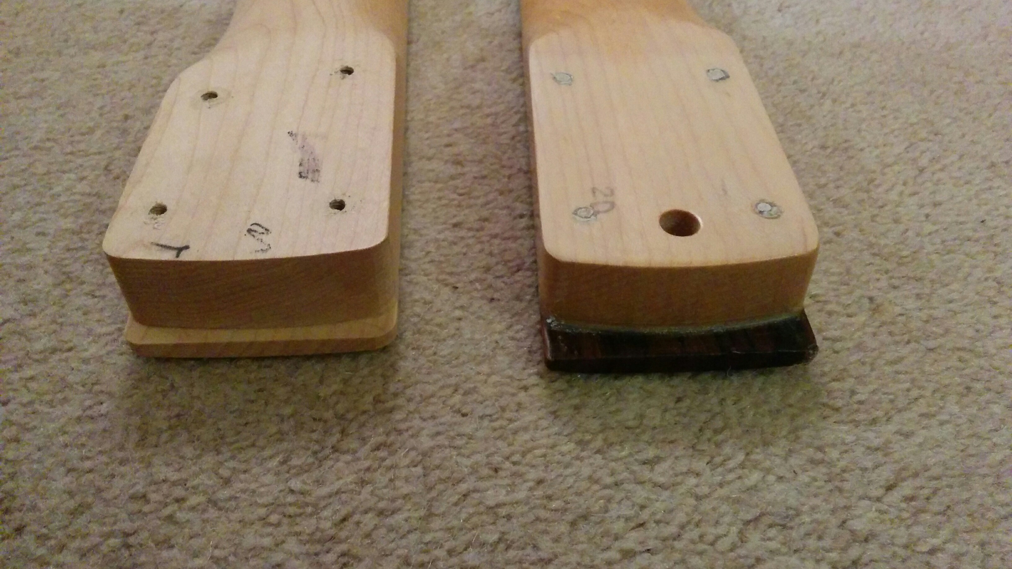

Yes, the shape of the heel is different but the width is the same.

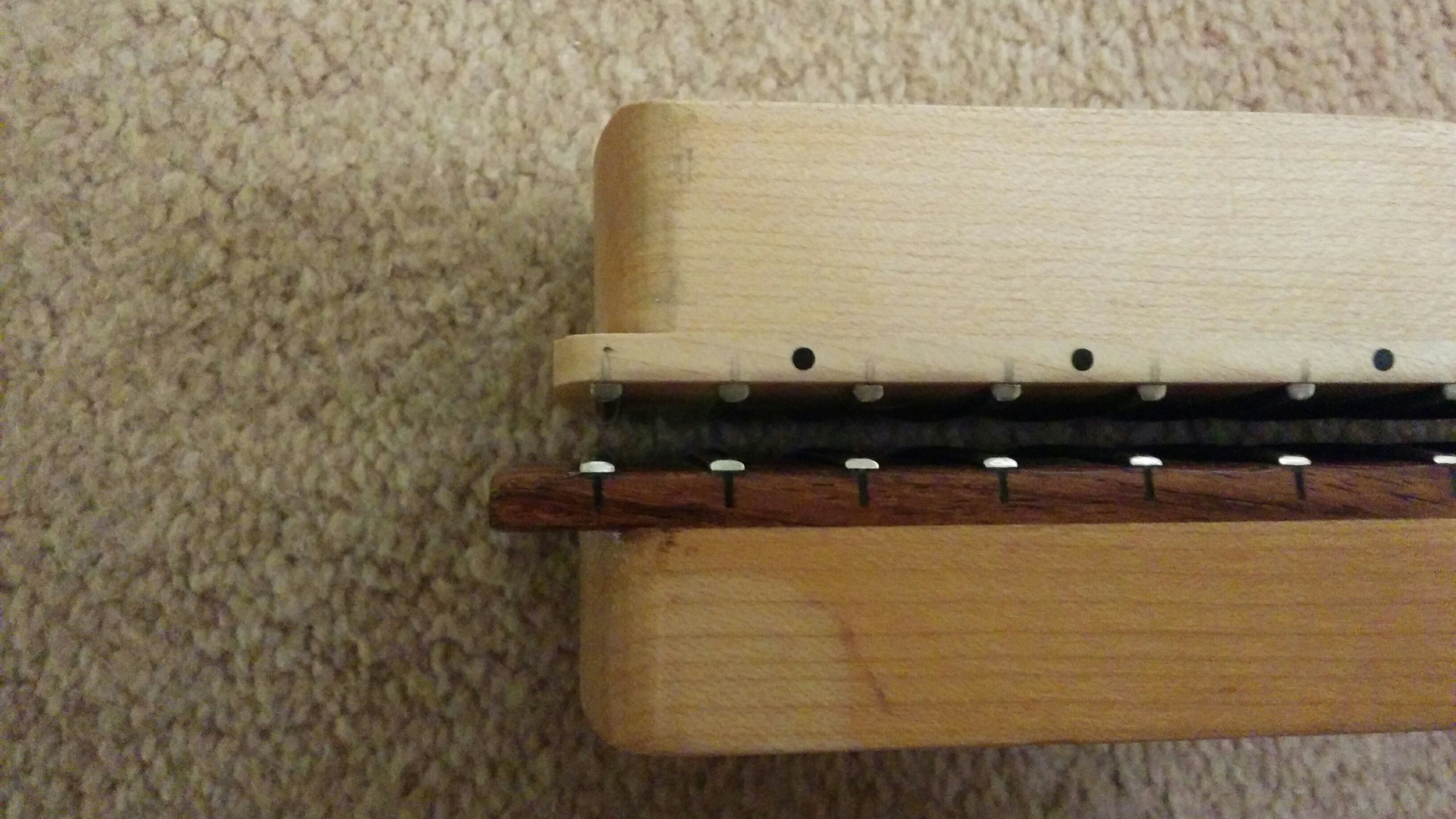

Ideally I what to sit the neck in the 'pocket' so the last fret is in exactly the same position. At the moment, it sits too far out, so the Charvel neck needs either filing, routing or some other method so the new neck fits snug.

I see. Use a rasp to trim back the heel of the neck, then sand it and finish it. Trying to do it with a power tool is too risky.

I had a brain wave!
The scratch plate should have a near perfect profile which I can check against.

Do a search for "spiling", you should find quite a few methods of transfering a profile, especially in boat building circles.

Transferring a profile is easy, use one of these:SimonD wrote:Do a search for "spiling", you should find quite a few methods of transfering a profile, especially in boat building circles.
