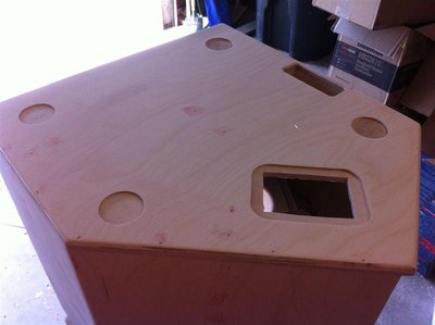

Hi Folks, I’m sure that there are many ways of doing this but I thought I might just document how I did it as the results were very good and it wasn’t too difficult. The only catch is that for routing the recess, you do have to have a routing bit of the right diameter for the corners. The bit I used was not off the shelf but I made it up out of a few other bits and pieces. I’ll get to the details of that later but enough to say that the diameter of the cutter is 1 5/8’ and the diameter of the guide bearing is ½’. I actually did the job in mm but for the sake of our US friends we’ll work in inches 
Basically I first cut out the main hole then used the hole as a guide for routing the recess. To do this you are forced to work from the outside inwards. The dimensions of the Penn handles that I have are:

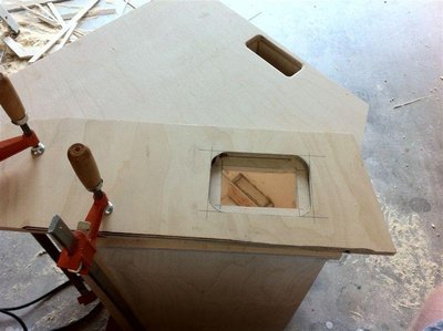

I used a common method for routing the cut-out buy first drawing the required cut-out on a template then measuring the offset of the edge of the router guide.
And attaching some guides to the template with double sided tape (I actually put some pins in the guides as well because the tape came loose the first time I tried to route :chainsaw: )

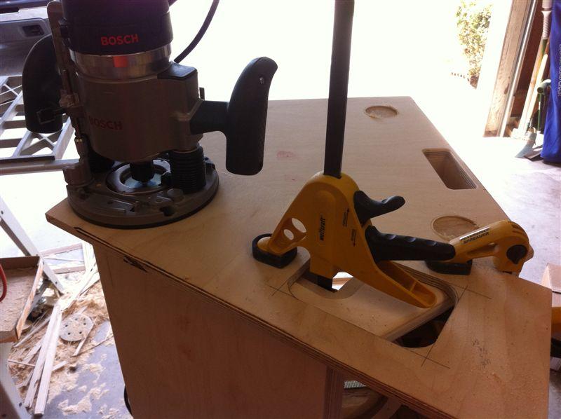

Using a 1/2' cutter I routed out the hole. It is worth noting that it is not critical if you make a mistake and gouge the edge of the cut-out as we leave the guide blocks attached to the template and actually use them for the real cut. This of course is not true if you are using a following bearing to do the actual cut.

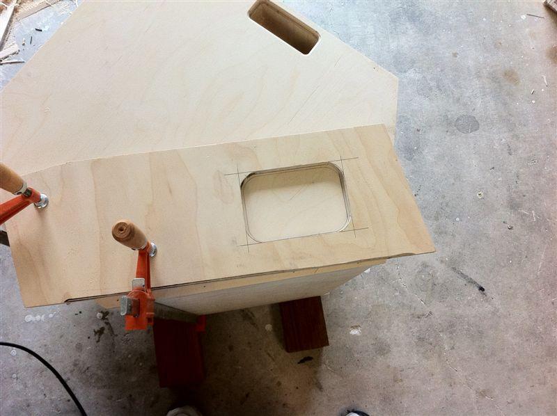

The template can now be used to route the cut-out in the boxes. Note that on my boxes I had already routed out the cut-outs so I just used the template to enlarge the cut-outs to the exact size. Thankfully my original cut-out was undersized. You would normally route the cut-outs before fitting the sides to the boxes.

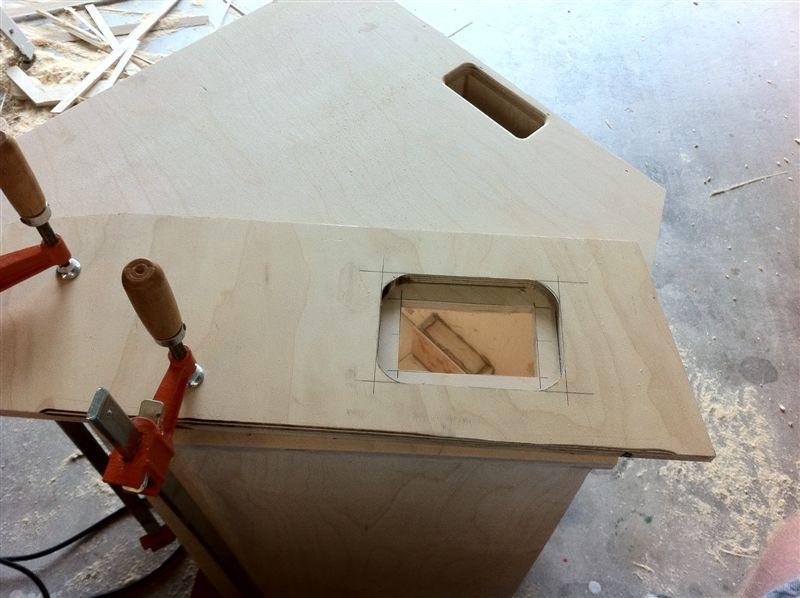

Once you have a nice neat cut-out you can use that as the guide for the recess route. I put together the cutter from the shaft of a buiscut cutter, the cutting blade from a rail and stile cutter and a bearing. I used the big router for this part as the cutting blade is too big for the little hand router
This is then used to route out the recess
Clean up the hole
And fit the handle. These actually came out perfectly with a press fit :hyper:
