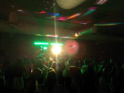

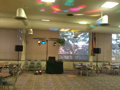

I've written about my lighting before on here, but I don't mind doing it again.
I have an inexpensive DMX controller (Chauvet Obey 40) and preprogrammed 8 scenes for dancing (and 8 for slow dances.) Some nights I push a button to change the lights every few songs, other nights I change them with each movement within the song. I run my music through a laptop, and I don't want to dual purpose my laptop or bring another when a rack-mounted unit can work with physical button pushes. I haven't seen any user-friendly DMX software, but I haven't looked since I bought my gear a few years back. All DMX controllers use 256 channels, by the nature of DMX, but they are limited on how many channels they can run per light. Some controllers can handle lights with 3 channels (they have 3 faders and are really cheap,) others handle 8 channels or even more. The one I have has 8 faders and a button that allows you to swith them to run 8 more channels (1-8 or 9-16.)
The job of lighting is setting the mood and enhancing the tempo of the music, so here's my breakdown in order of importance.
1st light, color wash: Change the room totally by making it colorful. I like color wash lights that have programmed movement, like Colorstrips or panels. You get both atmosphere and eye candy.
2nd light, movement: Moving dots or gobos make the room move. I have a Kinta X that does a great job filling the room with movement. The coolest I've seen is the Martin Wizard that one of the DJ's on this board has -- super bright and lots of movement. Lasers can do this, but you are limited on color.
3rd light, eye candy: Effects to add to the atmosphere. Scanners moving lights across the floor, dots blinking on and off, spinning patterns on the ceiling, lasers, strobes, mirror balls, etc.
