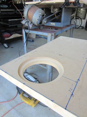

OK, I know I'm going to get it for asking, but I may as well ask. (the answer is always don't deviate from the plans)

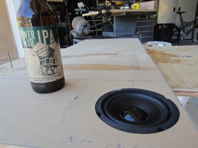

Would it be OK to add a 1/4" or so to the front baffle & sides height to allow for my flush mount step? Would the slight increase in volume of the enclosure be an issue? :confused:
I like the flush mount look. However, maybe it's a waste of time as I plan on making a grill / cover for it.
Scrap piece test hole pics:

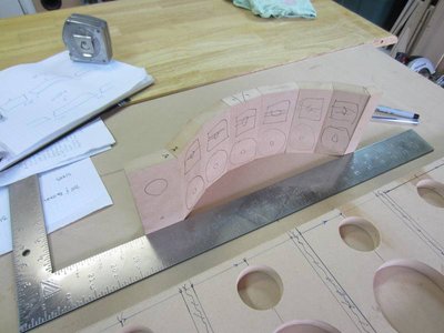

Today I finally got out in the garage and made a little model to better help me understand the angles and try out the table saw.

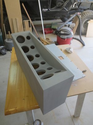

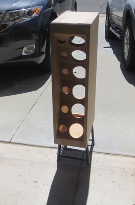

Almost done. I endured the heat for a few days and did some sanding and got some primer on it.
working on a grill frame too.

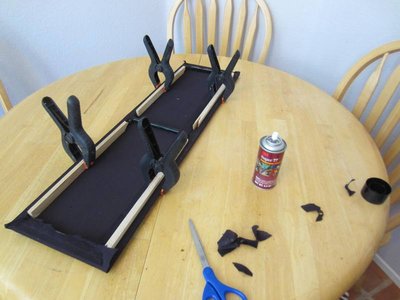

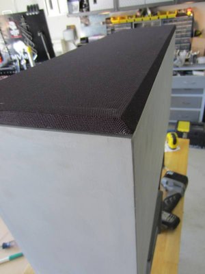

hey, thanks. it's my first attempt at making something look half way decent.
The grill cover came out, eh... OK I guess. I used spray adhesive instead of staples. had a bit of trouble in the corners and I got a little of the adhesive on the front of the cloth. but not bad for my first attempt I suppose. I also used some little ball and socket fasteners from Parts Express to attach it to the cabinet. I like them and would recommend using them, however you have to be careful drilling and tapping them in place when they are close to the edge of the cab. I got some small cracks in the MDF one a few of them.
