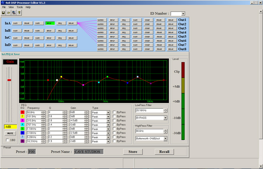

Here is my corrective EQ curve for my first gig with the otop 12 Jarray

Re: OTOP 12 JARRAY EQ
I would leave the dip at 4k and also dip 6 and 8k slightly. It is just to remove the sharp edges and pain in the ears for man and woman who are listening. Also it enables your audience to speak to each other instead of screaming into each others ears.
