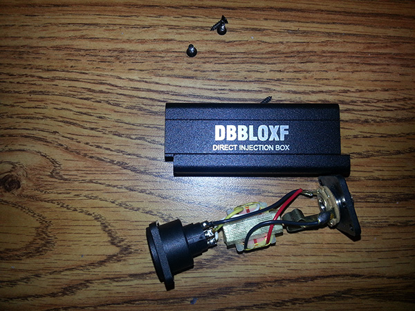

I came across a few very handy-looking RapcoHorizon DBBLOXF DI's... but they have a female XLR jack. I have panel mount male XLR jacks. Can I convert these over so I can toss them in the goody bag? Is it a simple matter of changing the jack? The innards look very simple, just a small transformer between 1/4" and XLR jacks. I have a handful of DI's, but you can never have too many. Plus, these are tiny. I could toss them into the acoustic guitarist's guitar cases for emergency spares.

That is exactly opposite of what you want. That box is designed to convert low impedance to high impedance - that's why the connection is wired that way....also why they are being cleaned out. It is very rare to convert a low impedance signal to a high impedance signal. Maybe for re-amping in the studio, but certainly not for what you want.

They might be non-directional....but I would doubt it. You could always use a gender changer and test it out. If it works - there ya' go.
But I would think it's probably used for hooking up a LOz mic to a HIz input.

According to the Rapco site, the two boxes are identical except for the XLR connector. Transformer is a 6:1 turns ratio with a 24db loss or gain, depending which way you use it. Reflected input impedance is about 21.5K ohm when plugged into a Low Z 600 ohm mic preamp input. http://www.rapcohorizon.com/p-366-dbblox.aspx
Swap out the XLR female for a male, and you're back to a standard DI box configuration.
The female version was apparently for matching a low Z mic to a hi Z preamp input, or used to drive a guitar amp input on a long balanced line as was suggested.
Years ago I built up some passive DI boxes with both male and female parallel connectors using Beyer transformers for exactly that purpose.
In the studio, I could mic up a guitar amp in an iso booth, and have the guitarist playing while sitting beside me in the control room. I simply plugged his guitar into one DI box, and then drove a balanced line to the iso booth via the control room patchbay, connected to another DI box plugged into the amp input in the booth.

The only thing is they seem to be missing the all-too-important ground lift switch and it doesn't appear there's enough space to install one.

Right. Space is definitely at a premium inside that housing. I guess I could work a few wooden extensions to house the xlr jack in order to free up enough room for a mini toggle...

Because you have zero$$ invested so far, for about $20.00 you could buy a Hammond box and move the works into a bigger enclosure. Add the switch for ground lift; you could even install a male and female XLR allowing it to be used both directions.
