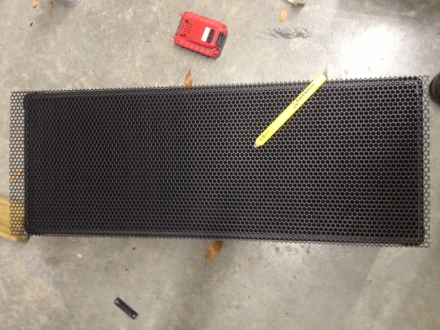

Hello,
I've read about metal grill guard material and that it has to be over 65% open. The only material I can find is an hexagonal hole in 22 gauge. That's rather thin. So I'm wondering what others have used and who was their source.
Reliable Hardware has a round hole 16 gage but that's only 62.4% open. They have an expanded metal but it's only 63%.

Thanks Sine, What size hole? I have seen that, but at 1/4" (6mm) it's only 58% free air. I don't think the 8 mm hole is much better. After reading at the forum, I was lead to believe that the designs (in this case the OT 12) needs 65% free air or better.sine143 wrote:parts express sell a decent 28 x 30 pair of flat grill (can cut yourself with tin snips). Its about 16 gauge.
Thus my question.

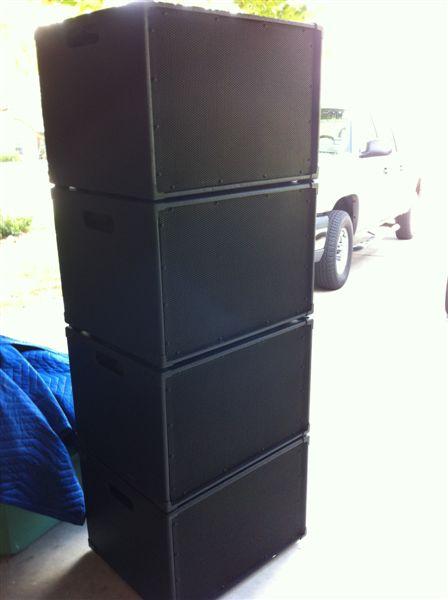

This is what I used.
http://www.reliablehardware.com/customs ... gered.aspx
The foam backer makes the cab look a whole lot better and you don't have to duratex the horn....
Here's without the foam - you can see the components This is with the foam...much cleaner look.
Re: Metal Grill guard material, speaker foam questions
Thanks Bruce,Bruce Weldy wrote:This is what I used.
So the 63% air space is adequate? Did you have them bend them? If yes, was it just a 90' bend or did you bend them over so to double the edge thickness. I was thinking this would be the simplest and then just flat mount them to strips using screws.
We're using the spray version of the duratex. It works real nice, not a lot of texture but that is fine. Thus the horn fronts will be coated. I believe Tim was doing that today. I'll be wiring and mounting the speakers tomorrow night.
The greater the open area the better, more than 60% (not 65%) is usual.
So 63% is fine.

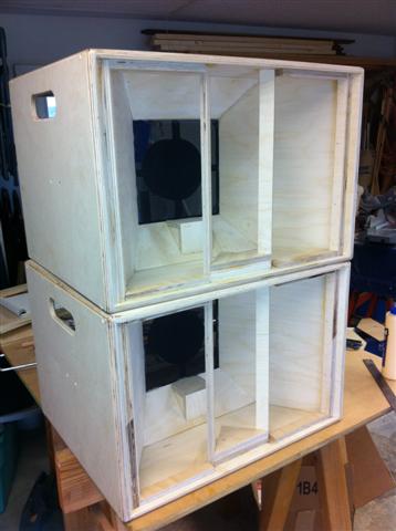

No bends at all. The key is putting the proper cleats in the box. I used cutoffs from the horn panels....turn 'em over and they create the perfect 90 degree angle. Here's a pic of the inside...

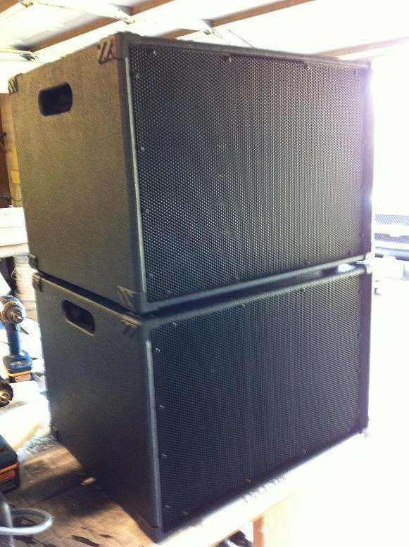

J_Dunavin wrote:Bruce
I love the finished look of your cabs! What foam did you use behind your grills? And how is the foam secured in there?
The foam is from Wal-Mart. It is air-conditioning filters for window units. Fits and OT12 perfectly with a little trimming.
Use spray adhesive. Spray the back of the grill, then put the foam on that. Cover with a piece of plywood and some weight to press it down while it dries.
Bruce, or anyone in the know, does mounting cleats in this way obstruct the horn in a way that could be detrimental to the output/sound of the cab? I thought messing with the horn panels was a no-no.
I'm nearing the stage of having to mount grills and am puzzling over which method to use. I'd like to try and avoid using screws on the front of the grill if possible, and am considering the various side-mount techniques available...

Nope.....cleat away....and if you use black grills and black screws, you can't see 'em.commander_dan wrote: Bruce, or anyone in the know, does mounting cleats in this way obstruct the horn in a way that could be detrimental to the output/sound of the cab? I thought messing with the horn panels was a no-no.
