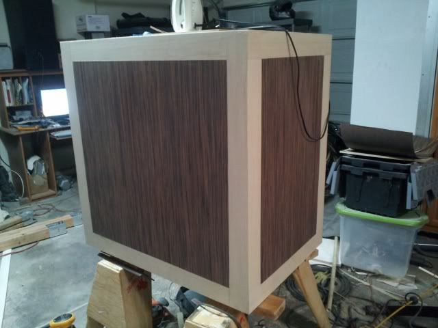

It looks good, but rocks and rolls.
How about veneering? Piece o' cake. One of the THTs I built and finished with Ebony and Maple veneer. Sorry I can't find the finished and poly'd cab. That one rocks and wobbles too.
