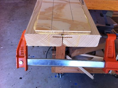

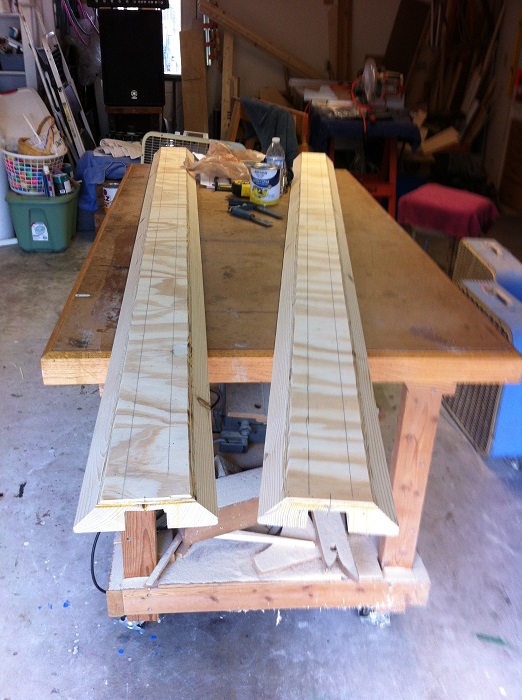

Start with two 2x4s. On the table saw, make a cut in each board.
Clamp the two together and add a top plate. I used some leftover 3/8" ply. Glue it an brad nail the hell out of it, being careful not to nail where you will be making the next cut.
Next, set your fence for the width you want and make the cut. Take out that section, flip it over and do it from the other side. Now that the notch is removed, set the saw to 45 degrees and take off the edges going through the top plate.

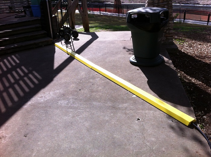

Now, to cover your butt - paint 'em bright yellow so even the blindest of dumbasses won't have any excuse for tripping over 'em.
It took about 15 seconds to place these over the snake and power cord instead of the several minutes and back-killing bending over it usually takes.

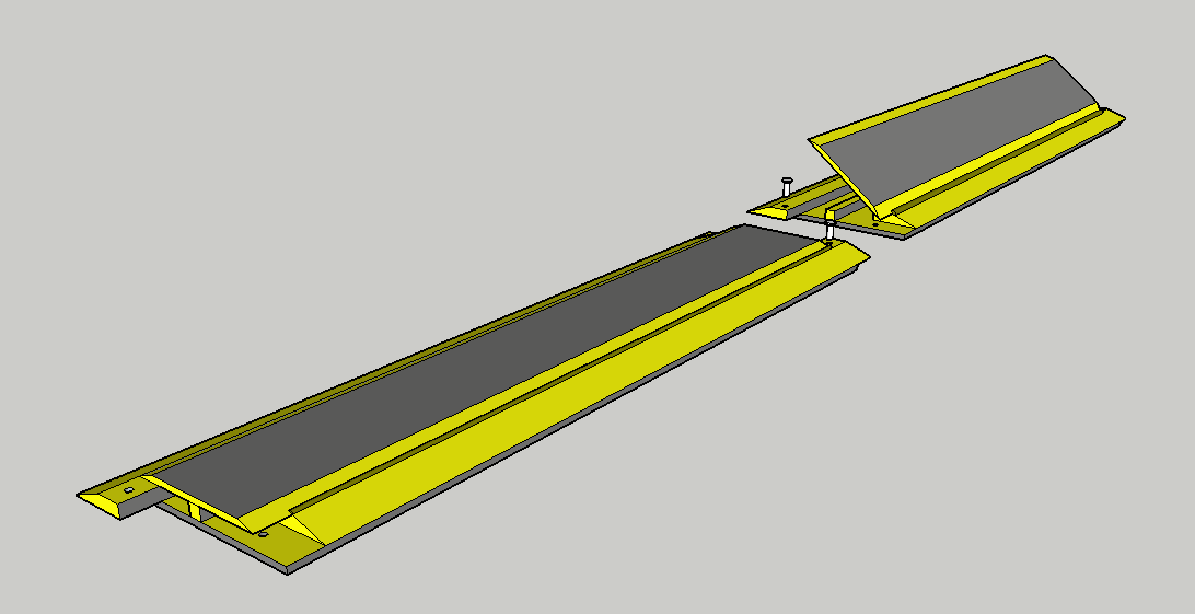

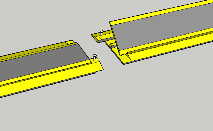

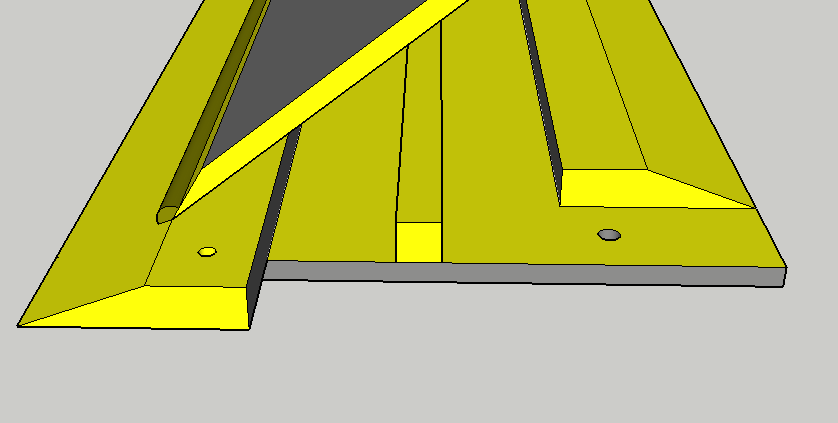

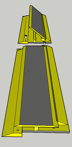

3/8" plywood top and bottom with 1x4 for the ramps and 1 x 3/4 for the middle divider. Black and yellow paint for safety of course. 3/8" pegs to hold the ramps in place.
Re: DIY Cable Ramps
It won't let me post the SKP file here... I would be happy to provide if someone wants.

Interesting idea. I think they might need to have more height to make the chamber a bit taller. I'd like at least 1" to fit a 3/4" snake with room to spare.Might end up a bit hefty (though the commercial rubber ones are heavy as well, so....)
Re: DIY Cable Ramps
@Nuke, I run a digital snake and my speaker cables are 1/2" OD. My sub snakes are almost always running around or under a stage... I'm really trying to limit height and ramp pitch for the audience. These were drawn with 3/4" height to the chamber.
