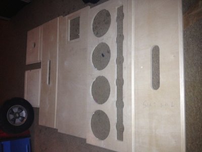

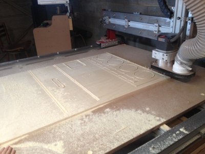

Picked up my BB today, going to be taking it to a friends cnc shop on Sunday, should make this about as easy as a lego set. Loading with daytons

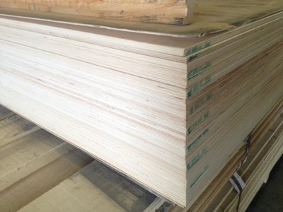

$27 a sheet b/bb baltic birch

What with that you are going to build the tallest array of SLA-pro's in history?sine143 wrote:$27 a sheet b/bb baltic birch
Re: SLA Pro build incoming
Haha nah im only building a pair, and a pair of subs. I was expecting to pay 40ish (and pay tax), but i was able to set up a wholesale account with the supplier using my new tax id # (so i got a discount and didnt pay 7% sales tax) so i said screw it and got 10 sheets

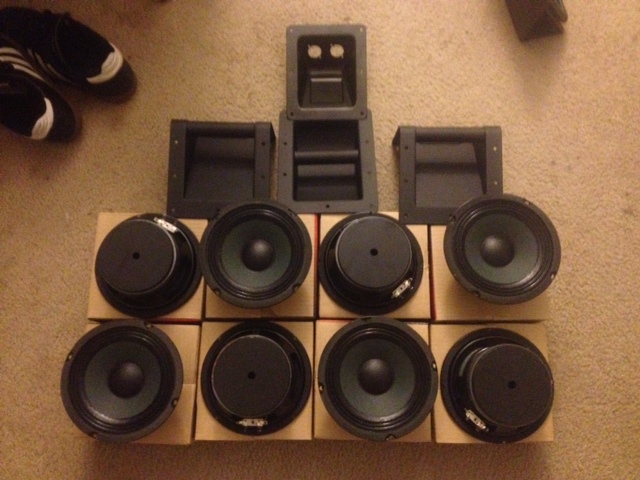

First shipment of parts came in, minus 2 of the 4 ohm resistors, the inukes, and the drivers for subs. almost everything in order. PE sent me a angle speakon dish that also had 1/4 cutouts for 1 of the 4 they sent, so got to get that taken care of. Havnt sent signal through the daytons pa 165s yet but will shortly.

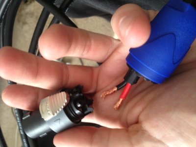

making some speakon cables..... 13 gauge PE dayton wire. seems decent. insulation is kind of soft but its clearly better quality than most 14 gauge cables I've see out there

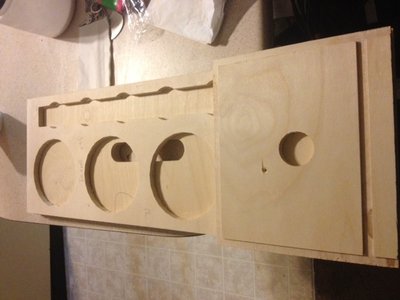

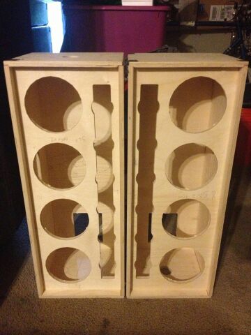

Some pics from today's progress. Did both

This and the subs, for monitors or a smaller stand-alone system?

haha, Its not my CNC. I drove 40 miles and offered a 6 pack of craft beer. It was actually by my friend four around 3k all out.

the pair of subs and these will be for a small (limited packspace) standalone system
The subs are non bfm due to the space restrictions (2 door honda civic), and are the result of my first successful fold. pm me for details if you'd like.
