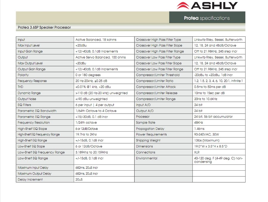

The Ashley DSP units look like a promising alternative to the typical Berry & DBX options. I notice Leland is now stocking them.
If you've had first hand experience with this unit, can you please share your experiences?
How many bands of EQ are they good for before they start running out of DSP juice?
Thanks!

I use the 3.6 in a small performance hall for up and coming acts out of Nashville. I love the thing. Its menus are so intuitive that it seems like child's play. I've not used the dbx or Behringer speaker management systems, but I understand from talking to those that have that this box REALLY excels in user friendliness. IMO, it is a must to use the Protea software for setup and adjustment. The USB interface makes it a snap. And although you cant 'directly' control the unit wirelessly, you could always tunnel into it through the connected laptop via VNC or similar. As far as running out of EQ juice? not sure what you mean, exactly. I've never experienced any sort of hiccup or latency from lots of adjustments. The spec sheet tells the story, though. Six input filters, four output filters per channel. Drag and drop routing of I/Os and just a very well thought out and constructed unit, like all of Ashly's stuff. I'd check out all the info on their website . . .
Can't go wrong! :wink:

Transparent, easy and powerful. AFAIC it smokes the dbx, deq, anything in the ballpark on price. That's why I now have Ashly.

Echoing others' sentiments, it's a great unit. Sound quality is perfect, setup is easy. The EQ is a little limited, but there's enough to do most jobs. If you need to do a lot of feedback notching, you'll need another EQ unit, as all the EQ in the Ashly is parametric and there's only about 10-12 bands available IIRC, split between input and output EQ sections.

But combined with a separate 31 band EQ, this should be more than sufficient, right?

Absolutely. I always use the parametric EQ in the Ashly for tuning, then use a 1/3 octave EQ or a feedback destroyer type product to ring out the nasties. Actually, the feedback destroyers work quite well for this since the filters are a lot smoother. As anti-Behringer as I am in general, the DEQ2496 and the FBQ2496 both work quite well for this, as do comparable products from Sabine, Shure, DBX, etc. If you already have the 1/3 octave EQ, use that.
If you're buying something, get a notch filtering device. Just don't run it in "live" mode... use it to ring out before hand and treat it like an EQ... set it and forget it. This is one reason I like the DEQ2496... in addition to the notch filter you get a 1/3 octave EQ in the same package.

I've been exploring units that would be capable of all my EQ needs (parametric response/room correction, Feedback notching, tone shaping) as well as x-over, filter, limiting etc, in the one box (ideally with a remote control option).
It looks like the Driverack PA2 comes the closest, but by most accounts driveracks are a PITA to use.
The Protea looks like a really good unit, but without a 31 band EQ on top of the parametric EQ, I'd still need something else besides the protea, so not enough for me to upgrade while I still have a working DCX2496.
I really like the idea of EQ recallability & built in RTA that both the Driverack PA2 & DEQ2496 could offer me, but on the other hand, I like the reach out & grabability of a standard 31 band EQ.
The DCX mentions midi control - has anyone tried operating it from a control surface like the BCF2000? Occasionally I get to use a Soundcraft Expression SI which can switch the moving faders to EQ mode - and I like it.
In fact I'm completely baffled that no one has brought out a dedicated 31 band moving fader control surface for DSP EQ's - you could control a whole rack of EQ's from one surface...
EDIT: Interestingly, the Ashly NXP series amps with Protea DSP do seem to include a 31 band as well as parametric (perhaps this is available only over remote with the system processors?), yet strangely, the suitable sized amps such as the NXP4004 & NXP4002 list the same output at both 8, 4, and 2 ohms!
