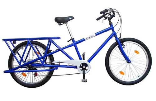

My son and I would like to build a sound system that can be transported on a cargo bike like this http://www.google.ch/imgres?sa=X&rlz=1C ... =0&ndsp=16

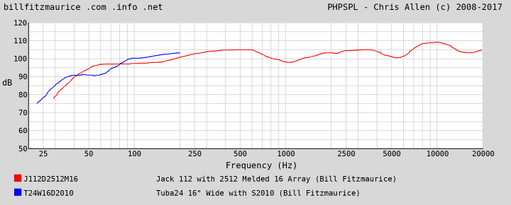

I'll give a +1 to the Jack 12 Lites, but a -1 for the Tuba 24s. Your power requirements for a "portable" mixer will be difficult to meet. For an amp, use a mono 12 automotive amp, and run the J12Ls in parallel off that. I -1 the Tubas (any subs), in this case, as portability is the #1 factor, leaving no room for subs or a crossover.
As you can see by the chart above, there is not much to be gained by adding in T24s. Just not worth the time and expense, in this case.

DJPhatman wrote: As you can see by the chart above, there is not much to be gained by adding in T24s. Just not worth the time and expense, in this case.
True, there doesn't seem to be much of an advantage to the T24s in low end. I imagined coupling them and hoping for something to bounce them off.

I've used this cargo bike, without electric assist, to move house several times (fridge, stove, lotsa boxes) and it surprisingly easy to move lots of gear, albeit slowly and surely. The only load I had trouble with was 2, 4-drawer old steel filing cabinets, but I tried to start out on a slight uphill incline. Once I got going, it's fine. So it's not much of a problem if the battery is almost drained after a gig.

The space on the lower racks is bigger than one thinks, the speaker can be up to 36" wide and 17"-24" tall (which would still keep the top rack space free for stands, etc.). The only limit on depth, is trying to keep it down to a maneuverable width in traffic, so under 30".

If I can make a suggestion ;) the Yuba Mundo is surprisingly stable, carries over 300lbs and is reasonably priced. Trikes are usually very heavy, not very maneuverable, and expensive. My 2c.
