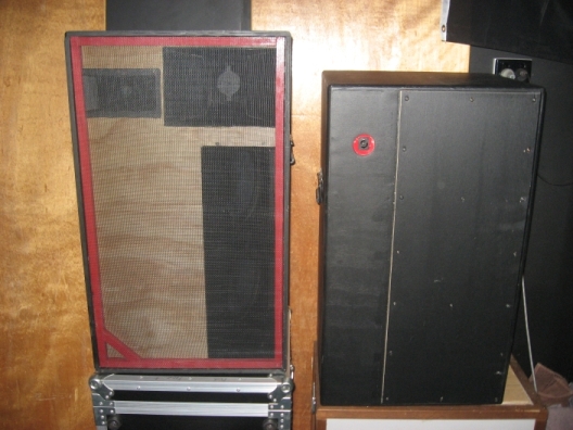

I finally got the OT12 – 210’s out to a live gig with a 4 piece rock band in a small venue. They do the job very well with enough volume and clarity. They have a smaller pack space than the rig I had been using, being a perfect fit with a pair of W8’s standing up across the back of the panel van. (Not using a sub also means one less amp.)
The rig used on Friday night was: Yamaha MG166 desk, DBX Driverack PA+, Yamaha PS350S amp and 2 O12 (2*BP 102). Foldback uses a DBX Driverack PX, Peavey CS800s amp and a pair of W8 melded array wedges. If anything the Yamaha power amp was a tad more than required for the job. (I might try the Peavey for FOH next gig.)
Clarity:
The O12, with APT 150 horn is very clear and crisp. The drum kit overheads never sounded so crisp and they managed to push the vocals through the mud of stage volume created by a Marshall stack with the bass turned up and a Peavey TNT bass amp with the bass knob cranked. The other notable thing for small venues was the dispersion of the mids being far wider than the Peavey HiSys they replaced.
Volume:
When setting the O12’s up in open air I was getting readings in the 120’s on my SP meter at 1 meter with CD’s playing at full tilt (just below distortion). The levels dropped off as distance increased, as expected, but the clarity never changed. Perfect for one of our open air gigs that requires 85 dB at 30 ft. (Plagued by library volumes even outdoors!!!!!)
Format:
These are the Tall Boy version using 2 * BP102’s. They weigh in at 27.5 kg. (Similar to the Peavey Hysis and lots lighter than the Peavey SP2’s.) I expect they would be lighter if I had used the 3012LF but I was lured by the flatter SPL curve of the 2*10 configuration.
First impressions:
So crisp and clear!! The dispersion is phenomenal!! Manageable as a 1 man lift Adequate volume for 90% of gigs.
Thanks Bill and TimA for the design and the development.

Those look great. Did you wanna see through the speaker grill covering, or is it just the flash?
MarcBass
Posts: 108
Joined: Thu Feb 23, 2012 6:41 pm
Location: Toowoomba, Qld, Australia
Re: Omni12TB (2*10)- First Live gig
#4 Post by MarcBass »
Thanks Grant. The woodworking is slowly improving. Not quite up to you yet, will have to settle for Omni Tops as the next build.
Jimbo, the grill was a very quick knockup using pet-screen. I'll order some perf plate this week. Originally, yes, I did want it see-through. The baffle is finished with gloss clear.
