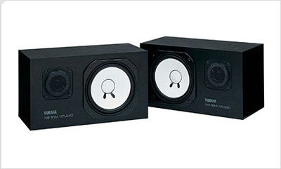

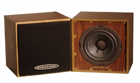

Which is why so many studios over the years have had these two venerable monitors inside them . . .
Dave H

Hackomatic wrote:
If you can get your mix to sound tolerable on the NS-10's, your work is done. Soo many people see them in studio's and actually think they must be great speakers. They are I guess ... at making everything played through them sound horrible.

CoronaOperator wrote:
Hackomatic wrote:
And that was the point. The original NS10s weren't supposed to be great studio speakers, but the engineers found that they were very representative of what the average listener had on their home stereo.....and that's who you were mixing for.

That's some good advice that Grant, Bruce and others are offering. Some of the best speakers for mixing aren't meant to make the sound pleasing, but more brutally representative of the music content.
NS10/M are exactly that, brutal. But if you can get your mix sounding tolerable on them, in most cases it'll sound reasonably good on anything else. I've never had good success trying to mix on headphones. It is however good to check your mix in them to see how it translates.
The little Auratones are simply a full range speaker, about 4 or 5 inches. They sound better than the NS10s. What I really find them useful for is mixing bass. I find bass is the hardest thing for me to get right in the mix. If you can get it so it's distinct on a 4 inch speaker, but not overbearing, it always translates well on any other speaker. The frequencies of interest are not where you would commonly expect them to be, but in the 100 to 800Hz range.
