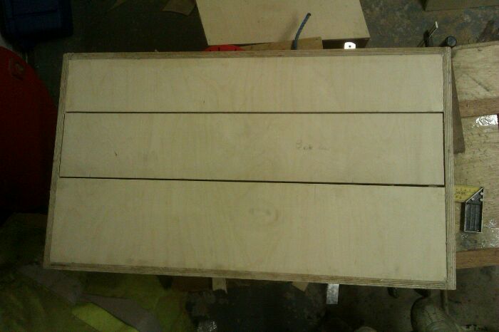

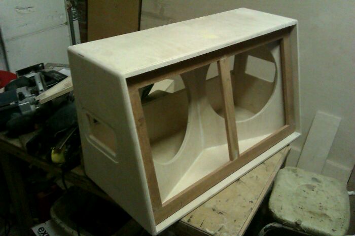

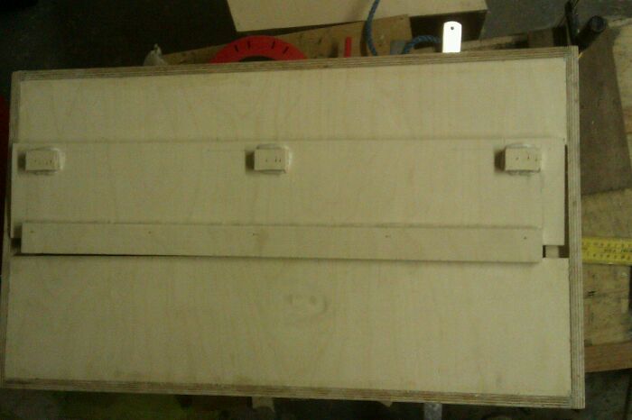

First pic: I found the gap round the removable back door to be generous when equispaced, so in the second picture, you can see 3 blocks, which are set in position to maintain the top and bottom gaps on the back door. The point is that the butterfly catches, that secure the back door, would close up the gap at the top otherwise, when they are tightened. Note, butterfly catches not set in yet.

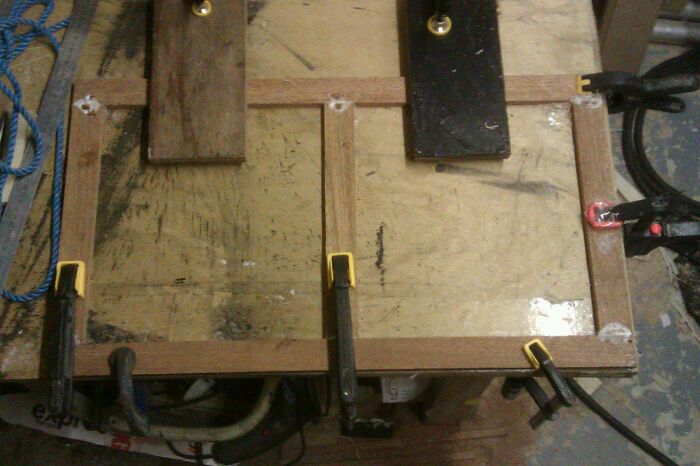

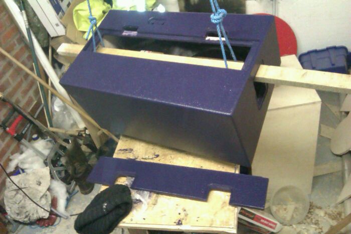

The 3rd picture is a little bit of hardwood from a scrap conservatory frame, to make the frame for the acoustic cloth front on the cab. This wood is far far straighter and stiffer than inch and a half wide strips of plywood. Although softwood would also do better than ply here.
Edit: its going to be harsh, painting the hardwood frame black, rather than letting the wood shine through the open black mesh i have, but, all the hardware is going to be black, so black it shall be.
So, I wasn't going to do this build thread, as the XF's are straightforward. But i came across a few things, so will put them here, to help others, should they wish to heed it, ...ok charles.

Realised when I was lying in bed last night that the gap, or any gap in fact isn't going to help with the butterfly catches, which butt up to each other when fastened - they have to be set in place to meet across the top gap, which may look slightly odd. I either live with this now, or modify or re-make the back door.

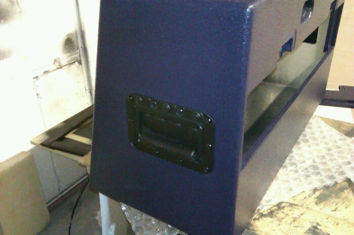

Ok. Well, I've moved the cab on a bit.

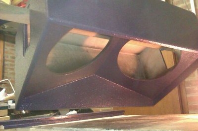

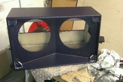

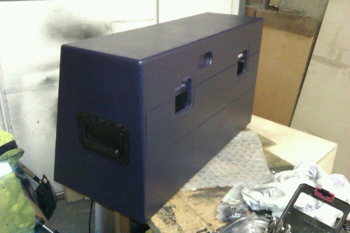

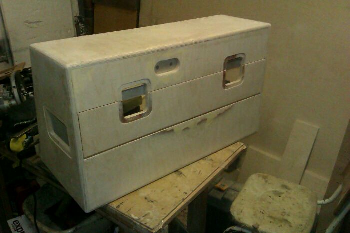

Firstly, I stuck the 3 blocks on the back door in the wrong place - I didn't knock off the gap distance when I positioned them(from the edge) so they didn't locate the door and maintain the gap distance, which was the intent. So, this being the case, and realising that the butterfly catches wouldn't look right meeting across a gap, I stuck a ¼” hard wood strip I had lying around onto the bottom of the back door to get rid of the gap, and also a bit of 3mm ply to the far narrow side to remove that gap also. This neatened it up a lot, but also showed the bottom piece of the back of the cab that it meets with was bent outwards, so that got planed down. The moral of the story is to cut the back door main piece after sticking the box together or anticipate/calculate the size more accurately and cut it correctly.

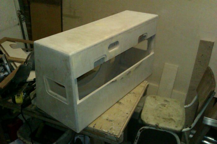

I made and used 4 templates to cut the flange profiles and cut-outs required (using router) for the sprung handles and butterfly catches. Then rounded over the edges, and made a 2-3mm recess where the back door flanges interface, for the foam gasket strip. I cut the recess using the router with 16mm diameter router guide plate and ½” cutter, so a 2-3mm uncut land exists, which means that the back door can be put in place and the small lands of un-recessed material still touch one another. This means that the (3mm thick) gasket strip is only compressed about 1mm, enough to do its job, but no more. I figure there are quite a few potential leak paths, in the closed back configuration, incorporating butterfly catches and jack plugs and all that – I’m banking on 95% sealing (plus the internal damping) being enough to get the closed back effect.
The paint is 'Funky Purple' (Blue Aran tuff cab) – my black woolly hat with obligatory PL streak is on the corner of the bench, for a colour reference. I sprayed the back of the baffles with a matt black – the other internal surfaces will have acoustic foam on.

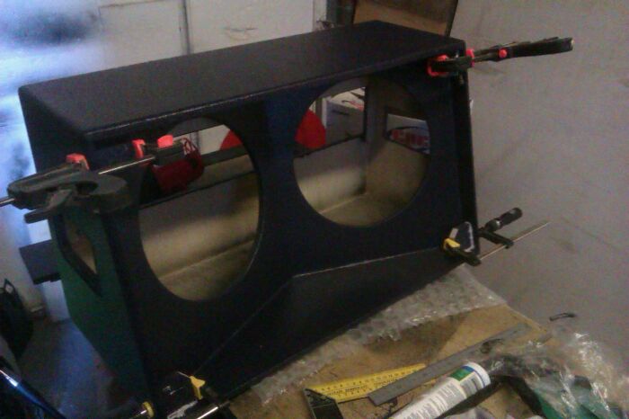

I haven't put the 2" square corner pieces in yet for locating the front frame, BUT I have masking taped where they are going to be PL'd in - I figure it's easier to paint the cab and corner pieces separately to get a neater finish, with a little bit of tidying after gluing them in. After making the frame, I'm intending to stick velcro onto the corner support pieces and back of the frame corners (once the grill cloth is stapled on) using PL - I hope it will work - the research I've done says it should.
The other cab you can see on its end is also an XF212 - it will have some vintage Goodmans drivers in.

Thanks Chris. There are still some joint lines showing through the now 3 coats of paint. I figure its the different nature/density of the PL adhesive compared to BB. It still looks DIY.

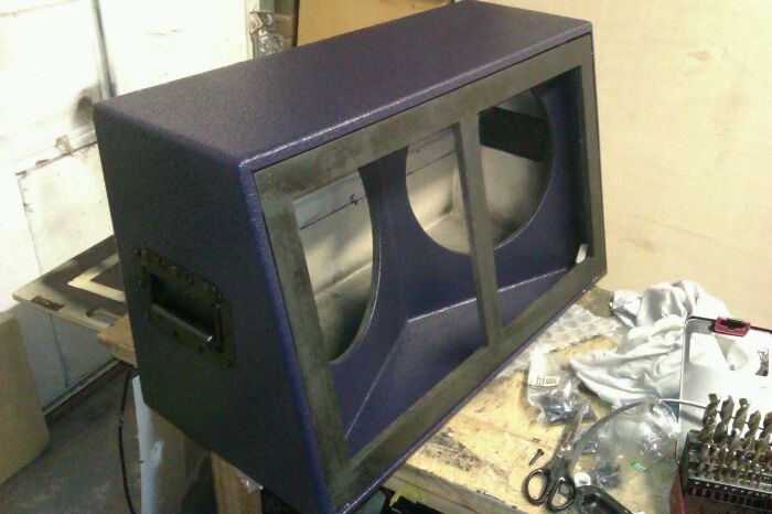

Anyhow, some more pics.
Fixing corner front frame mount blocks.
front blocks at bottom, chamfers trimmed back a bit, since overhang the inside edges of cloth support frame.
Swish penn sprung handles.
Snug fitting back door.
Front cloth frame resting in position. The black frame is grieving me, since I'm going to use semi-open mesh, the frame will show through, and its a bit industrial at the moment. Maybe a frame paint scheme will help a bit.
