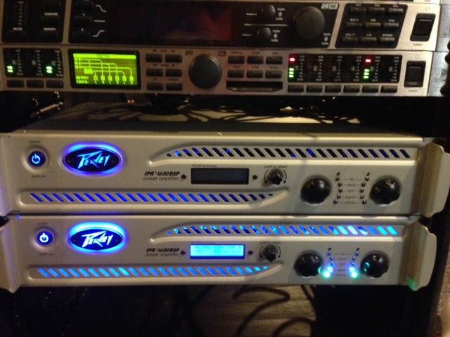

This was my son's first DJ gig, a snowflake dance at his high school. We used a pair of 3012LF loaded T-39s v-plated and wall loaded. The tops were a pair of OT-12s with the melded array. The speakers were driven with a pair of Peavey IPR 1600s plus a Behringer DEQ2496 and DCX2496 for the EQ and Crossover/Limiter. Overall the sound quality was great, far stronger bass than I was expecting. I measured the sound level at around 110 dBC running pretty much flat out. This was also the first time for the lights. Sorry about my poor video work, but I think you can get an idea of the sound clarity and bass.

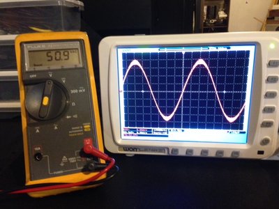

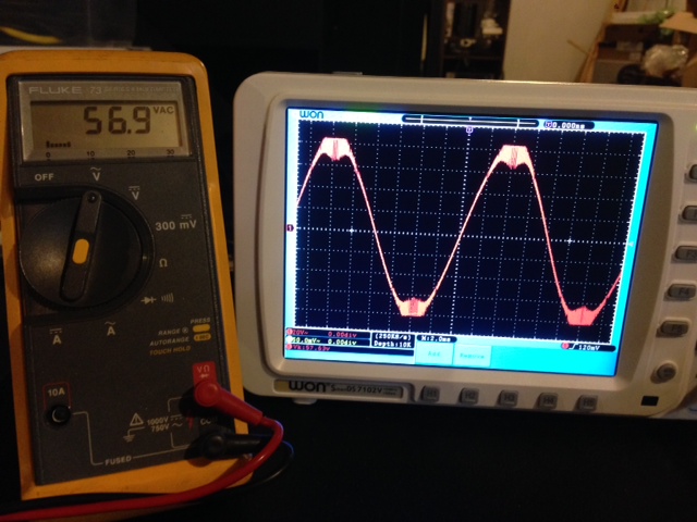

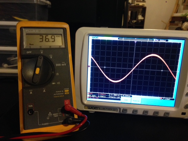

My curiosity was definitely peaked. Fortunately the equipment is all in the basement so it was easy enough to make a few measurements. What I found is that the limiters are setup okay. I also measured the amp when DDT was just engaging. To my surprise, at least with my amp unloaded, the DDT waveform looks a whole lot like clipping. Maybe in a more dynamic situation with a load DDT would work more smoothly.
The low tests were at 63Hz and high test was at 400Hz. The DCX worked great. The waveform remained nice and smooth even when driven well into limiting. Below are a few pictures:
