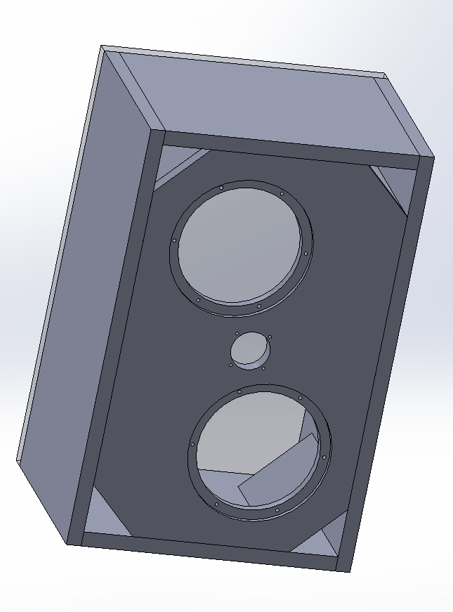

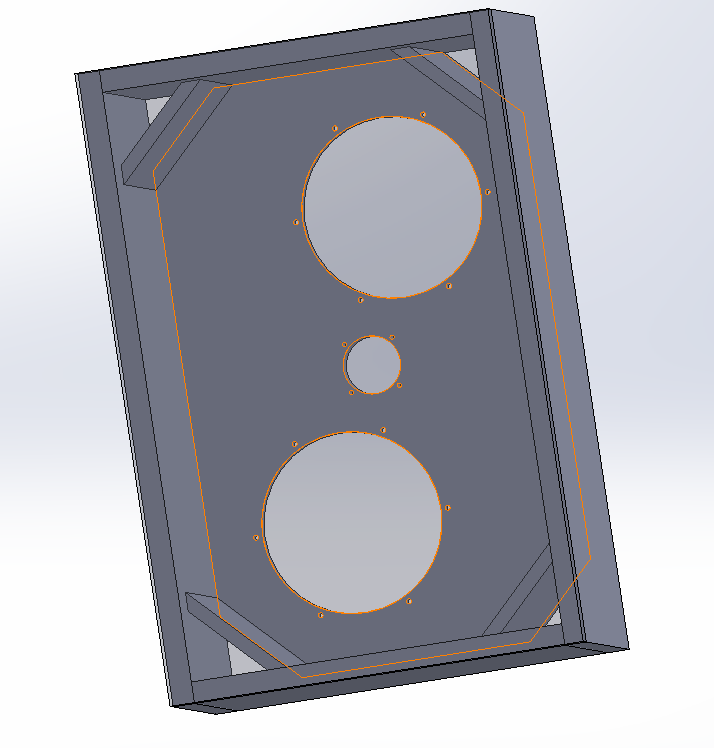

Here are some images (front isometric and rear isometric) of the speakers I'm designing and I was wondering if people had any suggestions as far as construction goes. The plan is to use maple plywood for the whole thing and put real maple strips on the front to hide the end grain of the plywood. I need feedback on whether the ports go too deep (they are the bassbox recommended length but my gut tells me they might be "starved" with the ends being ~2 inches from the back of the speaker).
