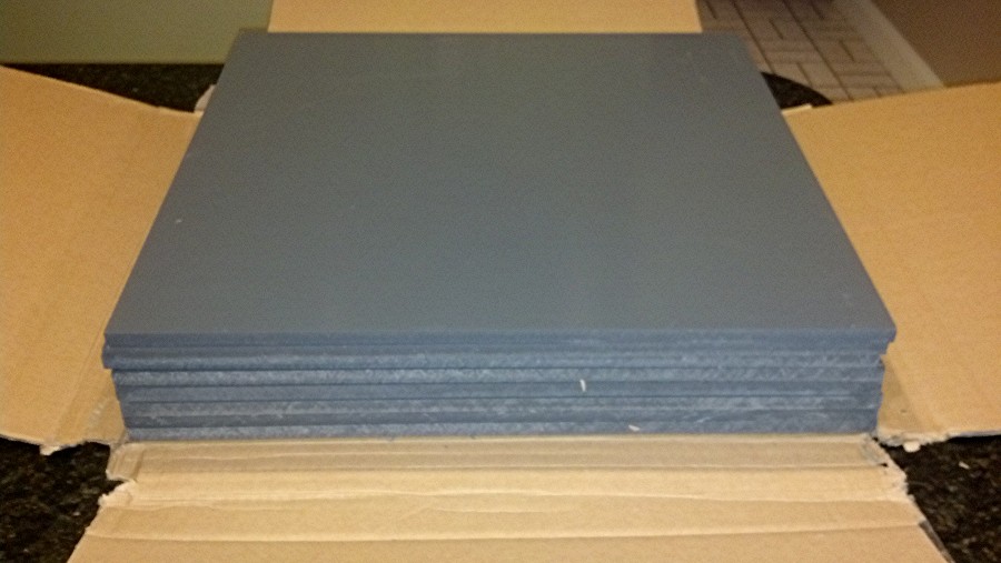

I've decided to give sheet PVC a try . . Gray, type 1, 1/2" thick, AND INCREDIBLY HEAVY! I knew that when I ordered it, but realizing this will be a permanent install without repeated schlepping, I ignored the back breaking properties. 8- 2 X 2 sheets, 120 lbs. :shock:

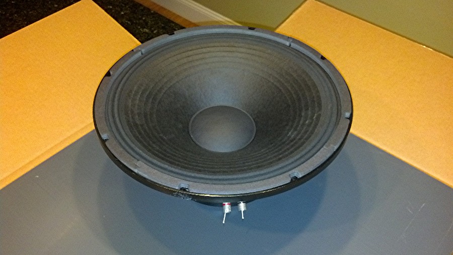

The re-coned Delta Pro 15 needing its tinsels trimmed and a coat of Wet Look sealant on the paper, begging for a place to land . . .

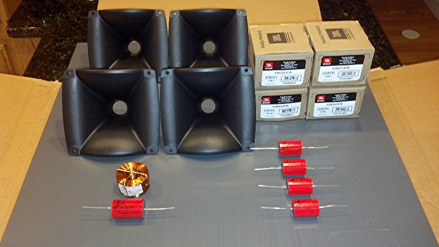

. . AND the high frequency section with the LP/ HP filter components. Again, preferred CD drivers, so got 4 JBL/ Selenium D202Ti drivers with HM 17-25 lenses. The 202s use the identical diaphragm as the 220s but with a smaller magnet and therefore smaller diameter, they will nestle nicely into the mouth. The four lenses stacked will fit PERFECTLY into the opening of the Otop 15. Jantzen 15 gauge .6mH choke and a 15uF Audyn cap for the woofer, and 10uF Audyn blockers for the 4 CDs.
Not real sure when I'll start paring plastic, but I have the beginnings of a good prototype in front of me. Figure when I get done slicing and dicing, these things are likely to come in in the 80 to 90 pound range. I guess we'll find out . . :lol:

1/2" solid plastic seems like overkill. I don't think any of the plastic cabs come that thick. Would 1/4" or 3/8" worked too? I know modifiying plans for material thickness is a PITA but jesus!

Hey, no kill like overkill, right? I am assuming you will use some PVC cement to assemble the cab? Not sure if PL will stick to plastic. I would also run beads of silicone on all seams to ensure air tightness, as well as to ensure no water seeps in.
On a weird, related note; I have always thought that those 1" thick PVC partitions you see in restrooms would make for some solid subwoofer boxes. :loler:

I like the way you think! Yes . . The thick, gray PVC cement that, of all things, is designed to fill the gaps. :lol: And again, yes . . beads of silicone on all the seams. I'm even considering doing that around the back cover . . could always be removed with a utility knife if access was necessary. In addition to the NL4MPR on the bottom, I'll be cutting the ports down there as well and mesh them to keep trespassing pests at bay.

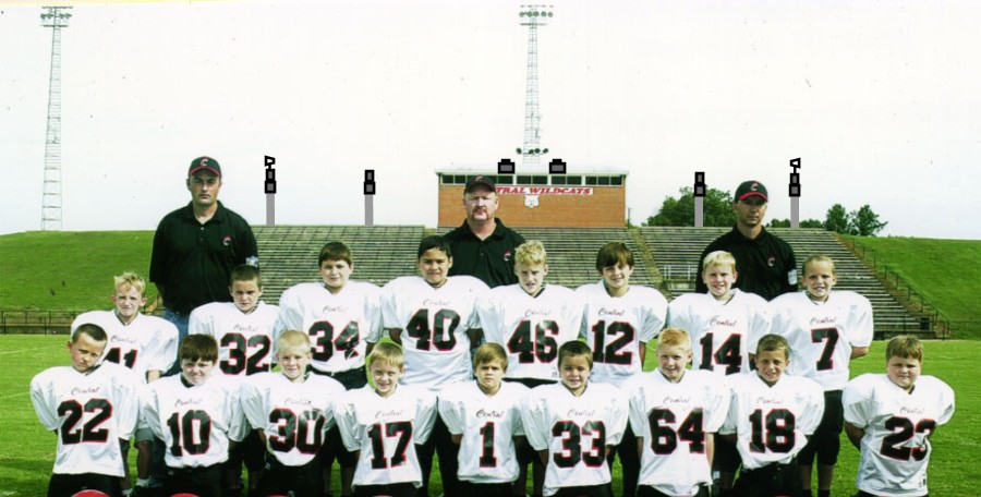

Just so I don't run out of things to think about, make some plans on the "complete" project, and enlist the opinions, knowledge and experience of the group, here is what I'm facing . . .
The pic is from 2005, before the four 20 foot towers and (what are now former) speakers were in place, hence the crude graphics. The system was (is) set up as a tri-amped arrangement. Each tower having a bi-amped 2-way on top and a separate amped sub on the bottom . .8 cabs total. The Press box had (has) two additional 18" sub boxes PLUS another pair of horns on top of those. Despite all the combing and nulls, if you sat in one spot it sounded pretty darn good, walk down the track perpendicular, however, and YIKES! :lol: Everything was reflex direct radiator. The two little cones showing at the top of the outside towers are Atlas Sound CobraFlex horns driven by the aux 1 send buss on the Yamaha console. The one on the right faces the parking lot, the one on the left, the concession stand. Their purpose is simply to carry the PA announcers voice to the far reaches of the site not covered by the other speakers. Nothing but voice goes through them. The big round horns on the big tower behind the press box do nothing except provide a place for wasps to build their nests.
So . . gimme some thoughts on how to arrange the 4- Otop 15s on the towers, any additional subs, and also think along the lines that I may eventually V plate a pair of T48s on the press box roof.

They have to go as in the picture?

Not necessarily. . The four towers are permanent fixtures, and I'm pretty sure they school is not gonna want to move them. BUT. . what if the cabinet configuration was shuffled? As in, splayed Otops on the inner towers with subs on the outer towers? or vice versa . . . And the press box roof can become whatever is necessary. I'll entertain all ideas . .short of relocating the four towers. :?
Dave H

Subs work best on the ground.
If you stick them up on the poles, you'll simply need more...
Re: Weatherproof Otop 15 Build . . . finally
#12 Post by DJPhatman »
Grant Bunter wrote:Subs work best on the ground.
+100. Having the subs off the ground puts them in free space, or -6dB, IIRC. I know for sure it is NFG. As far as tops placement is concerned, I would want to be able to place them near each goal line, turned in toward the center of the field, for the most coverage. Put the subs on the ground, under the bleachers if possible.
You could also place all 4 OTops on top of the press box, 2 on each side, cross-fired for maximum coverage, and tilted probably 15-30 degrees down.

Yeah, I'm painfully aware that subs work better at ground level. Unfortunately, the chances are pretty much zilch on being able to do that. As you will notice in the pic, the bleachers are in the side of a hill . . nothing but solid concrete where the seats are set. I fear sub placement will end up being a series of compromises, or as Grant points out just keep building and adding!
Dave H

Hackomatic wrote:Yeah, I'm painfully aware that subs work better at ground level. Unfortunately, the chances are pretty much zilch on being able to do that. As you will notice in the pic, the bleachers are in the side of a hill . . nothing but solid concrete where the seats are set. I fear sub placement will end up being a series of compromises, or as Grant points out just keep building and adding!
Yep.
I'm pretty sure DJP's assessment of -6db sounds right by putting them up in the air.
That means you will need to double cab count to bring you back to equivalent of ground placed subs.
But if you throw in a V plate on a pair, that normally ups output by 3dB, but will not be that figure when not at ground level. Maybe half ie 1.5dB.
So if you built 4 cabs, put them up on the booth and V plated both pair you might be, at best, a bit above a pair V plated on the ground...

Sounds like I'm gonna need to do a structural analysis of the roof! And speaking of the roof . . is there any thing to be gained by its boundary?
