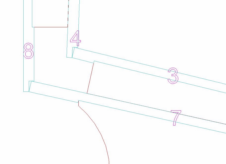

While I can cut miters with my machine, it is rather tricky and requires long machining times. However, these plans looked simple enough that I could get by with rabbets and dados and all right angled edges as depicted in the picture. The expanding properties of the PL Premium should have no trouble filling the cavities, based on prior experience. Note that for ease of placement the braces (in red) are also pocketed .1 inch. The numbers correspond to the panel numbers called for in the plans and will be lightly machined on each panel (you can barely make them out in the rendering). Disclaimer: I hate to have to do any measuring, cutting, or marking on any of the pieces after they are cut out.

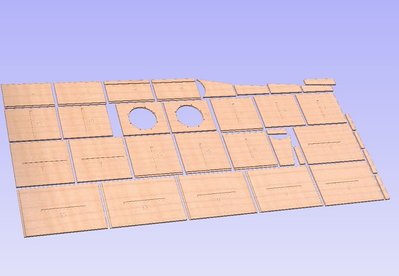

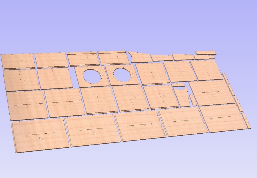

Preliminary nesting reveals that I can get the pieces for two of these on one sheet of 1/2" thick 4x8 plywood as shown. I intend to cut the end pieces from 3/4 inch plywood. The reason being I'll have extra thickness for the rabbets for the panels to slip into on the inside (.25" deep), not shown yet.

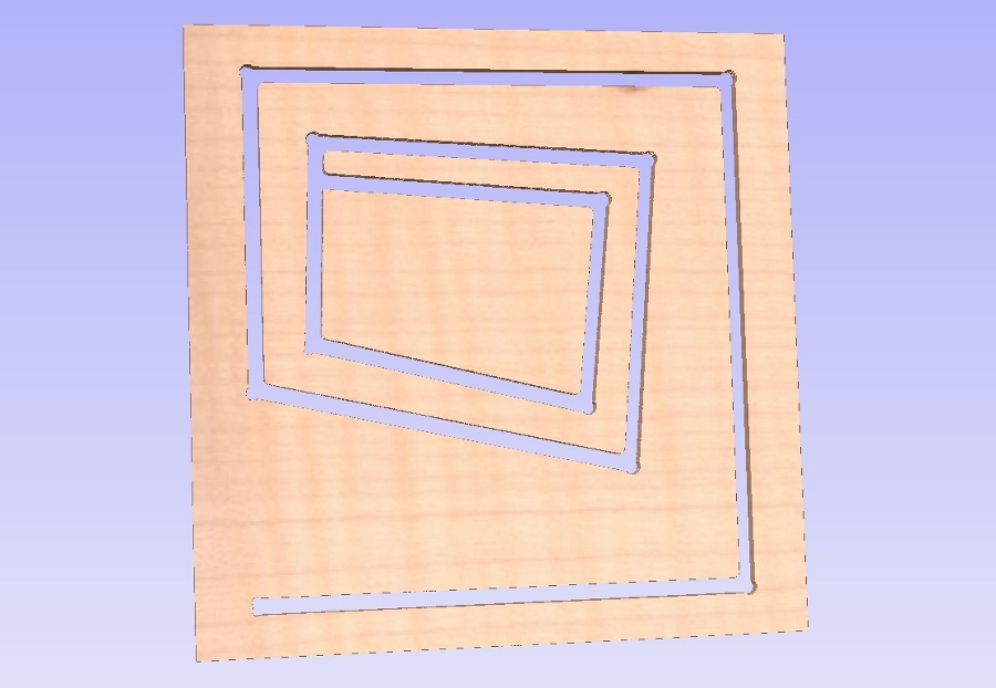

What I have shown however, is a piece with the scroll pattern cut out (.030 oversize) to use as a jig for keeping the panels aligned as they are assembled, not sure how well that will work out, we'll see.
