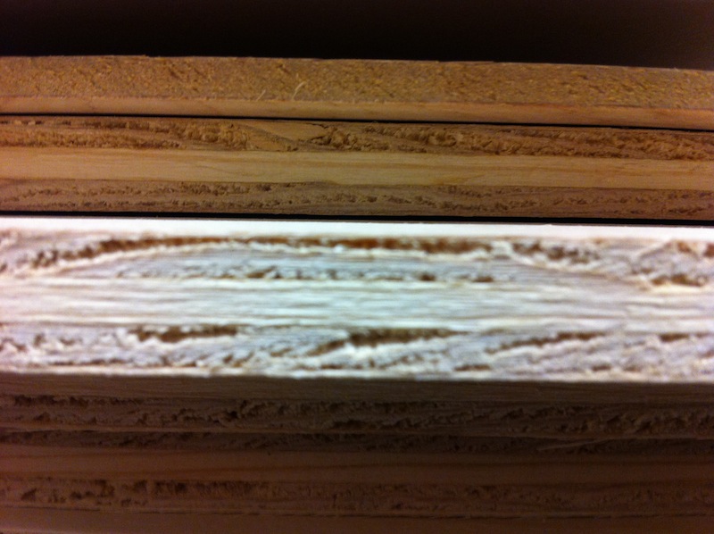

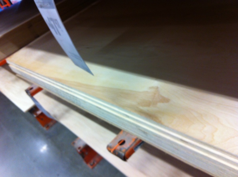

Read your plans some more, Chris. It tells you that you may use fir, spruce, pine or even poplar plywood, as long as it has at least 5 equal thickness plies, no voids and no thin veneers. Look at the last picture you posted. I see 3 plies with a super thin veneer on the top and bottom. NFG.ChrisMcCune wrote:Ok. Thanks Bruce, thats what I was thinking. My only other option to BB is Auraco Pine ply right?
When you call around for the plywood, ask for baltic, Russian or Finnish birch. You may also use Radiata pine or Poplar plywood, if it is available. The important part that must be adhered to is a minimum of 5 equal plies. Arauco plywood is known to meet this requirement.
Check out the pictures at http://www.araucoply.com/index.asp They show exactly what the ends should look like.

It matters not for your conclusion DJP but that is not the real super thin veneer. At least not as I know it. I will see your crap ply and raise you a hair thin layerDJPhatman wrote:Look at the last picture you posted. I see 3 plies with a super thin veneer on the top and bottom. NFG.
All joking aside I have seen ply where the outer ply face was no more than a hair thick. A fraction of that outer ply there. You really couldn't tell there actually was an additional outer veneer layer other than peeling it with a nail on the edge. Only then did it show. I had almost bought a full sheet. That would have been a disappointment.
Still I do agree: don't use that ply there, just saying there is even worse.
