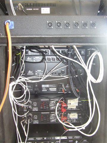

Build a rack panel like this - you'll never regret it.

Thank you sir for the info on the amp levels and the picture. I'm working two extra jobs to come up with extra $ to build my system. I just finished a shift from one. That combined with looking at the picture has me motivated to go ahead and buy the ampBruce Weldy wrote:The amp volumes should be wide open all the time. Control the input from your board, driverack, etc.MisterB wrote:Great suggestions, it will be for a mobile setup but the amp is made for an installation... other obstacle is that the volume knobs will be in the back. That will probably be a p.i.t.a. till I get a good idea of where I want the levels to be set.
I rent systems often and the local audio rental place here always has amp and panel mounted in an amp rack together. Their panel has in/out xlr jacks for left and right side as well as two speakon jacks per channel. It is very handy being able to daisy chain the xlr cables as well as having another set of speaker jacks if necessary. Their panel has proven very usefull and I highly recommend it. Unlike Bruces picture however they mount their panel on the front of the case. That too has proven useful when making system changes on the fly in very dark rooms.

Yeah, in a rental kit, that's probably a good idea. But, with personal stuff, I wouldn't want to give up the real estate on the front.CoronaOperator wrote: Unlike Bruces picture however they mount their panel on the front of the case. That too has proven useful when making system changes on the fly in very dark rooms.
I'm down to a single 1U space left. Probably could lose the dbx231 EQ now that I have all that on the Presonus for monitors. I keep thinking that one day someone will hire me to do some little show where I'll use my old board that's still in the top of that rack......waiting.....waiting...and if I got a show like that....I'd probably still use the Presonus.
