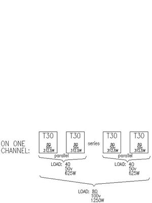

I have a specific scenario I’ve been (theoretically) pondering, in regard to total potential number of LAB 12 T30’s I could load onto the following amp in respect of restraining the cost of amp purchases. Roughly speaking I’m thinking of a max total of 8 T30 cabs [to match with 4 tops].
http://en.synq-audio.com/product/267/DIGIT-3K6
but there is a big difference between the 8ohm and the 4ohm power rating of the amp, and it’s not obvious to me why it is so…? But it stuffs up the calc’s and substack to amp matching.
The scenario is explained in the sketch below:
2 cabs per channel seems fine (4ohm load and loads of power available for this specific amp – great!)
But at four cabs per channel, I don’t seem to be able to get less than an 8 ohm total load, and then one can’t get the power rating required (whereas at 4ohm the total power required (1250w) per channel would be well within the amps capability!)
Is there something I’m missing? Would I be unwise running 1 or 2 cabs per channel off an amp with this capability and ultimately get 2 of something smaller?
Even if you bung them all (8 cabs) on the one channel in bridge-mode then I can’t do the math to get an 8-ohm load out of 8 cabs! (where the power available at 8-ohm is 3600W). It ends up back at 4-ohm. :noob:
2xT30

#11 Post by Bas Gooiker »
I would advise noone to run all their cabs of one amp or amp channel. If one of your drivers dies in a series parralel configuration you will screw up the whole line.
And if you want to run 4 ohm bridge mode you need a diffrent kind of amp.
My advise would be to get 2 smaller amps and run 2 cabs parallel per channel. With Lab 12's this would already give you a nominal 3ohm load. Or if you need max power and durability, on a budget, with the option of running 4 cabs parallel per channel look for something like http://www.thomann.de/nl/tamp_proline_3000.htm. just a little heavier than the synq 8)
