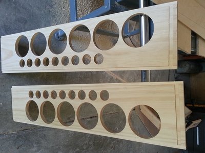

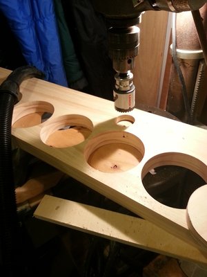

Tweeter holes finished tonight, hoping that crossover, baffle staining, polarity check/wiring, and rear piece construction get done tomorrow. I'm feeling ambitious. Too bad my paycheck hasn't processed yet I was hoping to get my duratex + goodies order shipped today from speakerhardware.
All done.
For the record they were clamped together and I went through both baffles in the same go (clearing out the hole saw as necessary).

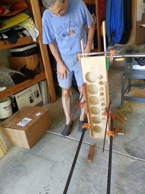

Posted: Sat Jun 22, 2013 3:32 pm
by MissileCrisis
Sides and bottom (meaning the 4x8 bottom since it is a rectangular build, the "top" is open as in the plans) glued in their convenient dado slots :) Note the back is simply a spacer at the moment and is not glued (removable by means of screws + weather stripping is the plan))
