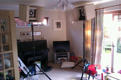

I gave the Proel's a last look at due to their attractive price, but they didn't have the gas spring assist in them. So, I went by H W Audio on the way home from work and bagged a pair of Ultimate Support TS100B's for a 149 quid. I didn't tell them I hadnt seen them for less than 190-ish anywhere else. Still, £150 for a pair of speaker stands is going some. After getting them home and trying them out, they are definitely Buy Once, cry once, but smile everytime thereafter. Check the pics.
Here it is with the partially completed J12L, on the ceiling (2.4metres) - good for half space loading.

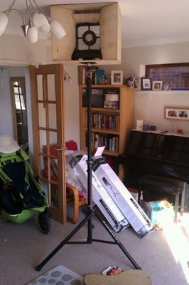

Here's the tilting top hat head pulp set up.

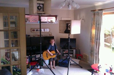

And lastly, the shortest and almost the tallest positions. The cab bottom was about 6 to 8 inch below my shoulder height at the shortest setting.
My smile was as wide as Noah's (with the guitar), playing with these bad boys.
...is bad boys still an in phrase, or am I off piste?
Noah was trying to put things (kiddies toy stacking cubes that fit inside one another!) on the little red chair in the picture, and stand on them to be as high as the speaker. He slid off at the first attempt so i told him the band stays on the ground. When we took the jacks off the stands he tested them, by shouting into the front and back of the cab, "testing, eight, two, four, one, testing, eight"

Way to go Charles!
They look like they'll be good...
