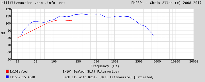

I'm thinking 2 J115 lites. I wouldn't do a 2x15 Jack, as that would be BIG, though not as big as a 6x10 Ampeg!
Response will smooth out a bit more with 2 J115s, but you get the idea!
