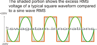

It is not only the amplitude (height, voltage) of the wave, but the shape of the wave that determines current (watts, area under the curve of the wave). To illustrate, notice the square and sine waves in the diagram of the same voltage... but the square wave has far more RMS current.
The same is true of music program versus straight sine waves. Thusly, amps can push out brief periods of power from their capacitors above the "limit" of 1800w or 2400w.. but.....
