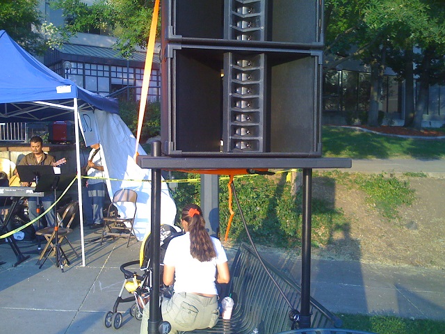

Stands
Stands
Nothing on the eyebolt that I could find. Pretty simple though. The tophats have 4 screw holes each 1/4 way around the flange. I took out one screw and replaced it with a hole drilled all the way through the platform for an eyebolt. The platform is sandwiched between a washer and nut on the top side and the flange and a nut on the bottom to keep it secure. My only complaint is the nut on the bottom which doesn't sit flush and pretty like your flanges. None of mine is flush or as pretty so I don't worry too much. I had a photo somewhere showing one OT12 strapped and hanging from the bottom of the platform and three stacked on top.
It cost a big chunk but I just recently upgraded to the Ultimate lighting stands that will go up about 8.5ft. Used those for the first time this weekend and it was all nice and solid. Now I'd like to swap the tophats for something in a bigger diameter since the pop-up extension on the stands leaves just a little wobble room.
