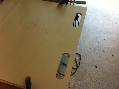

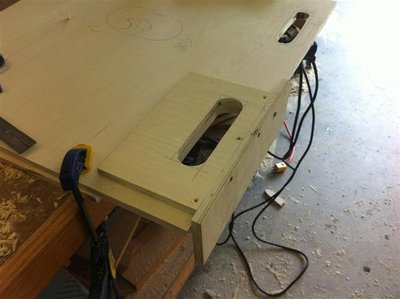

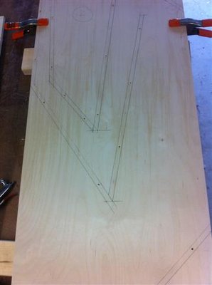

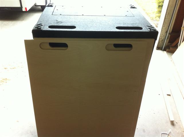

First out of the box - draw it out. Then place the other side behind it, clamp it together, then drill your holes through both boards at once - now the other side is ready to slap on at the end. Cutting the handholds was a pain last time, this time I built a jig. You only have to cut the handhold one time in the jig. Clamp it or screw it to the top, then rough cut inside the hole with spade bits and/or a jigsaw - then use a pattern bit and a router. You only need to use the jig for one top panel. Then use that panel to be the template for the other top and the back panels (you'll have to use a spacer to get the alignment right on the backs, then clamp it and start cutting).

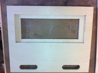

Here's the finished product...

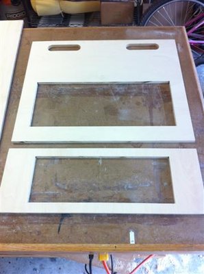

I'd like to give credit where it's due, but I can't remember who suggested this approach to the access cover panel cleats.....this is much easier than cutting and putting in separate strips. Just cut the panel with the same bevels that you would the strips...do a little measuring, then cut out the middle.

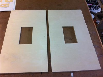

Here's the baffles. I did all of the "holes" in the tops, access cover cleats, and baffles on the table saw using a "rising" cut by bringing the blade up slowly into the wood. Makes really nice internal cuts...

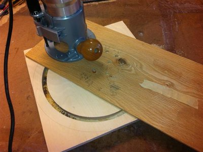

And last, but not least.....one day I may buy one of those expensive circle-cutting jigs for my router. But for now, the old piece of scrap paneling and a 3/8" dowel works just fine.
