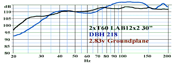

Two T60s, dual LAB 12 loaded, versus a DBH 218. Similar size, weight and impedance. Not a very similar price, though.
Like most 18 loaded subs the DBH 218 has too short a horn to go really low. A better comparison would be to a pair of 2x12 T48s, which would at least match it in a similar pack space.

The -10db cutoff is 28hz... Which makes it T60 territory. As the lowest frequency with Bills cabs is also atleast 10 db down.Radian wrote:They don't compare because...For starters, comparing it to the T60 is all sorts of wrong.on1sony wrote:Putting aside weight and price...![]()

And to top it off it looks like the 117db rating is at 95hz or so. I would rather have the 105db at 25hz from the T60's and the giant pile of cash that's left over to put in the mouth of the T60's to see how far I could shoot it across the room
