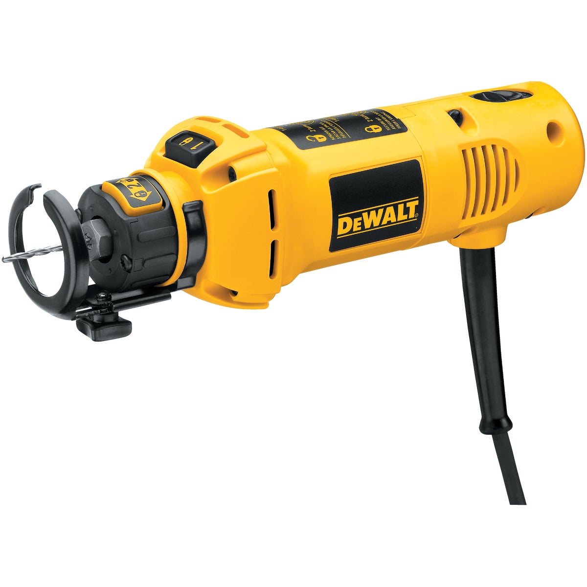

Would a cutout saw like the pic below work well for cutting holes and access panels instead of a bulky router? I'd like to think it'll be great for smaller pieces/holes and maybe larger ones too. The only downside I can imagine is the thickness of the wood, possibly stability issues and breaking bits.

jimbo7 wrote:Would a cutout saw like the pic below work well for cutting holes and access panels instead of a bulky router?
No, you'll go through bits like Tiger Woods goes through women. :loler:
I don't use mine for anything more than 1/4" thick, other than drywall.

After some research, I found that most use this for cutting drywall or thin metal and wood.
