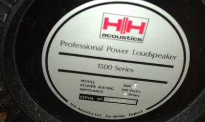

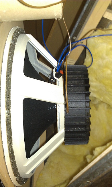

Can you post a picture of your driver possibly? There a quite a few of the older Harrison cabinets that are actually really nice, and quality made.

Oh, and Bas, I´ll post a few pictures of the woofer when I get home, almost 100% that I have a few pic at home:) It does look like a good driver to me:)

So, I found a few pictures of the woofer in my 1x15", here comes:

Are these old cabinets? Are they vintage cabs or are they part of the newer Performer range?
Fane did make some oem drivers for Harrisons, they are based on cheaper Fanes.
But looking at your magnet with the heatsinks they might actually be Goodmans. If i remember correctly they have a magnesium chassis, not aluminum.

Well, I bought the cabs used about 12-13 years ago, and they were probably a couple of years old already, I´d guess that they are maybe 20 years old or so :p But I havent used them very much, not the last 8years or so, and they werent really in a bad shape.
The cabs are nicely made, with fixings for a protective frontplate, steel profiles around all edges and such.
Sadly the steel profiles looks rather bad now, but felt like waaay to much work to get them of, so we just painted the ugly plywood, it looked like plywood stained with some green/gray smear:P Ugly as hell, but now they look rather good in their new textured black:)
Yeah, those magnets have always felt good! Magnesium baskets sounds cool! I sadly dont know anything more about them:( Am I right in thinking that you think they seem to be worth keeping and upgrading?
