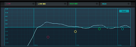

So I've got my 2 dr 200's before my T39 is ready, and this is the graph of my first EQ set up. I don't know much of what im doing, but I ran smaart with an RTA while adjusting filters in a Crown XTi 2002.

Any advice for changing it?

Looks believable. My experience has been that a narrow shallow cut somewhere between 5 and 7k improves the sound of the array quite a bit, but it's been a while.
