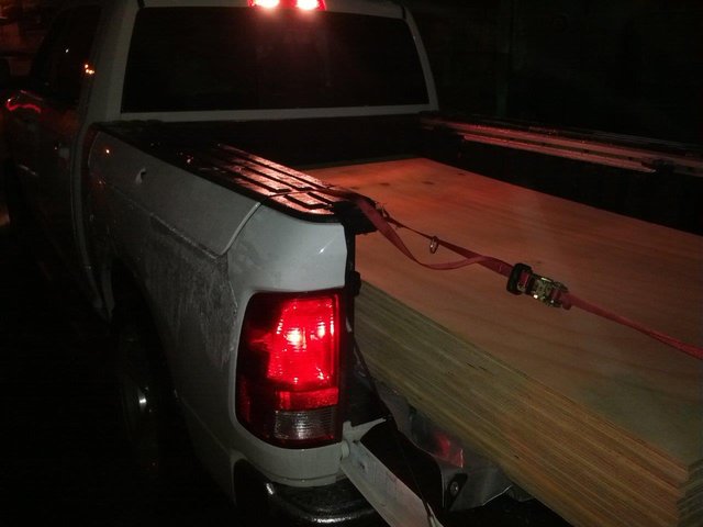

For plywood, I have been having a very hard time finding suitable material after the Arauco plant burnt down. Baltic Birch is a couple mortgage payments for me, so I had been holding off. I hit my local hardware store the other day, he had 22 sheets of Arauco in house, 2 were damaged. I bought all 20 at a decent price, but when he reorders... $47.99 a sheet. So looks like I better enjoy my T48 build thoroughly until wood comes down again.
Here's a shot of the new sawdust in the bed of my new (used) truck.
