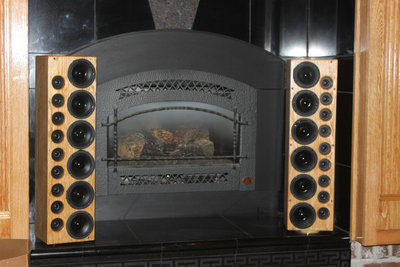

The SLA's were my first BFM project, so my build process wasn't as amazing as yours. But they turned out good and has a high WAF.
Of course their final resting place is not right next to the fireplace...
I left the mounting holes on the front.

hs123 wrote:The SLA's were my first BFM project, so my build process wasn't as amazing as yours. But they turned out good and has a high WAF.
Very nice!! I see you rounded your baffle edges. I was thinking of leaving mine square. What do you think?

Re: SLA's for the home.
#8 Post by hs123 »
I was rounding everything. It did seem to make sense, it softened the look, and made the stain flow more evenly. But I like the way yours look too!
