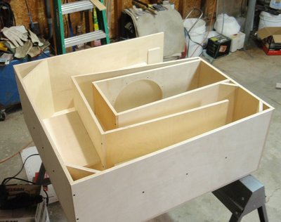

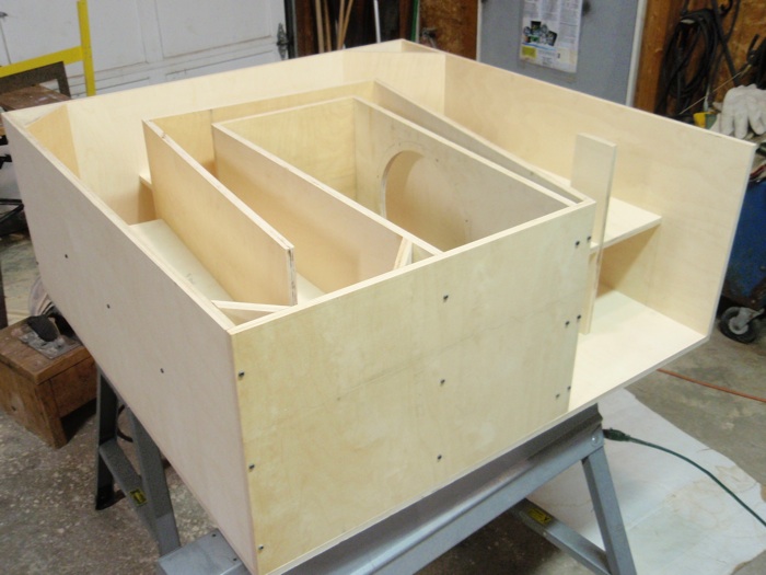

Behold...a rare species of THT.
This was supposed to be a twin build (two 12"-loaded slims), but the building supply co. messed up the order of BB, thus I ended up with only enough material to build one cabinet for now. :bash:
1. Dry fitting
1. Dry fitting
2. Anyone for a game of Labyrinth?

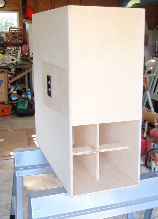

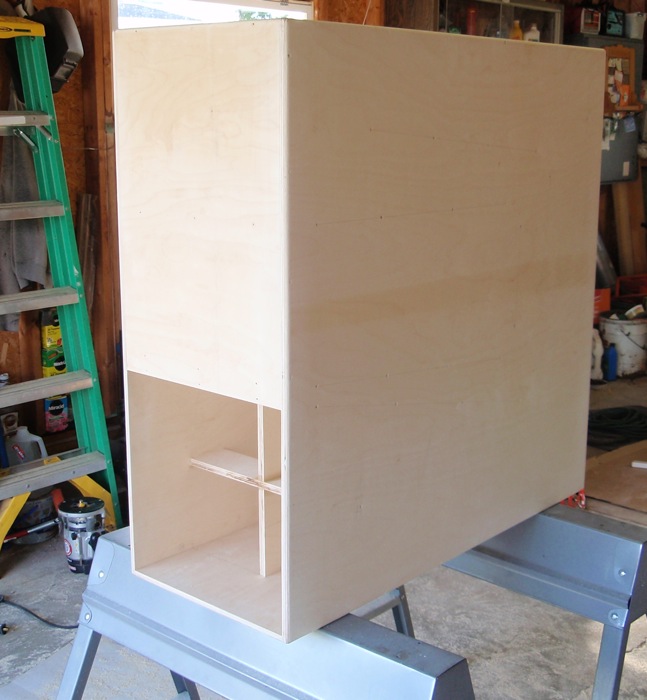

3. Sawdust and assembly complete
4. Half way there... ;-)

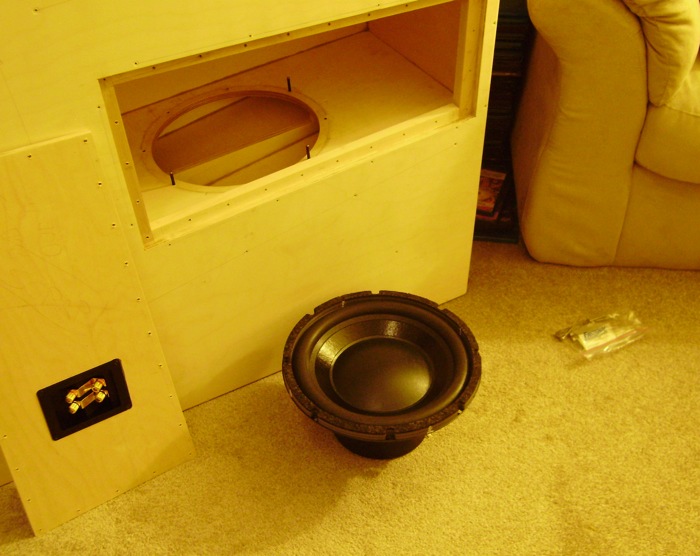

A little further today. Access panel drilled and driver installed. So far, a quick low-level check reveals it does indeed make bass. :P Tomorrow, I'll put the spurs to it after a thorough leak check and impedance sweep. Then it's back outside for cosmetic finishing.
T/S parameters checked, run-in for a few days, and gasket sealed. Dowel pins help line up the driver to the h-nuts in the baffle.

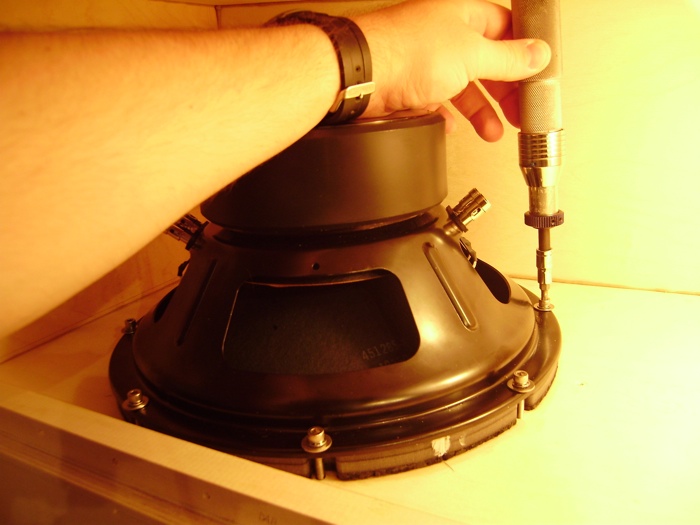

Initial tightening of fasteners. A second pass tomorrow will insure a good seal after the gasket settles. Coating the upper half of the bolt threads with rubber cement before installing, keeps them air tight.
