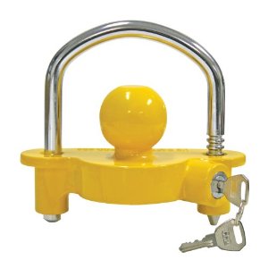

Do you know anyone locally with garage space to rent cheap? Maybe someone retired and living alone without a car? I'd be advertising to find such a place. a trailer is just too easy to hitch up to a vehicle once the perp knows you're out of town.
Posts: 8664
Re: Gear in a trailer
#14 Post by Bruce Weldy »
wounded horse wrote:Do you know anyone locally with garage space to rent cheap? Maybe someone retired and living alone without a car? I'd be advertising to find such a place. a trailer is just too easy to hitch up to a vehicle once the perp knows you're out of town.
That's why they make locks.
Jon Barnhardt
Posts: 718
#15 Post by Jon Barnhardt »
and boltcutters and cordless metal saws...
Chicken/Egg scenario.
Personally I leave my trailer locked (door and hitch) inside my (locked) shop.
