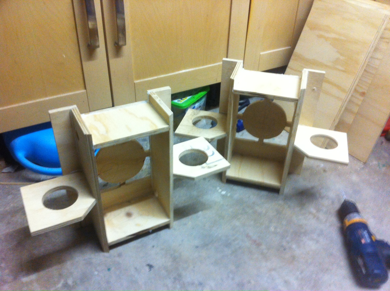

So, it's time for some new speakers.
I needed some more as my first gig without a backline is this Friday, so naturally, I start building the speakers I need yesterday - I took the day off and started cutting wood.
I'm fortunate enough to own a table saw, so that makes things much quicker but it hadn't seen action for over a year, so it need a bit of TLC before I started.
My original plan was to build W10 and make them with a full height melded array so I could use them as tops but given the time constraints, I decided on some simpler Jack 110's with a wedge slice. I would compensate for the reduced volume by making the top of the cab deeper.
For driver choice, I already had a pair of Beta 10's but I decided to order some Fane Sovereign 10-125's. They meet the specs for Jack (just!) and have a vd of 183cc, which is higher than the 2510 and much higher than the Beta 10. If they turn out to be crap, I can always put the Beta's in. I got them on sale for £30 each.
I've taken some pictures with my iPhone (which I got covered in glue!) so I'm just waiting to get those off.
