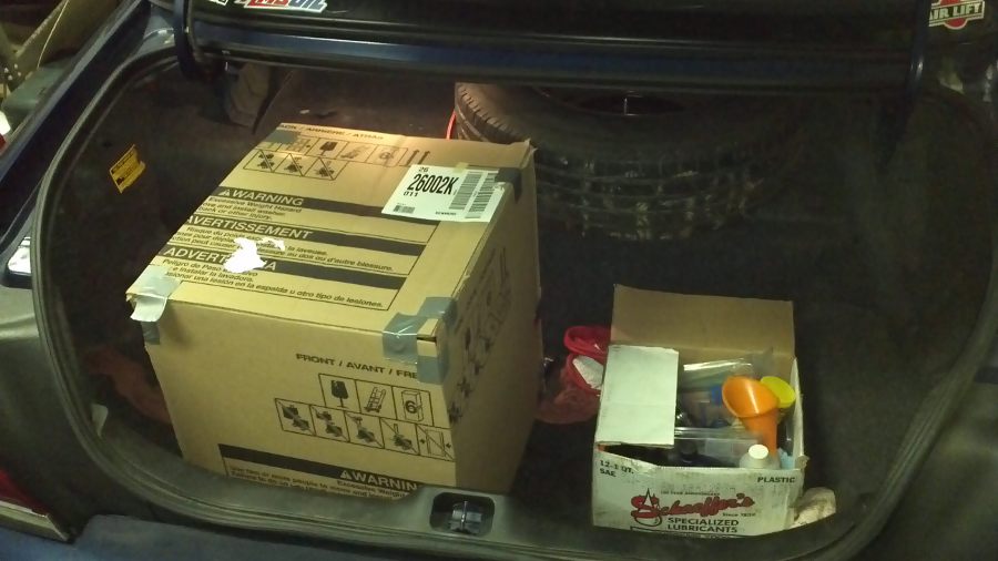

So, I Im going to need another sheet of BB. I kept going back and measuring. Looking at it some more, measuring some more. Couldnt decide if the TAT would fit. I finally decided to make a mock up of a full width 18" (single 8") TAT.
I think I like it. If I put it upside down, itll be pointing right over the shelf at the back seat. Muhahaha.
Drawing the wood usage out, Ive found that unless I use 13 inch panels max Im going to run out of wood with a TAT. So if Im going to buy another piece of wood, I might as well go max panel width, eh?
Funny side note. I was driving around today with the mockup in the trunk and seen someone I knew, so I made a quick turn into a parking lot and did a 180 to pull back out behind them. At some point during this maneuver, the box hooked on the child safety trunk release, and pulled it enough to cause my trunk to pop open. Embarrassing making a stop and having the trunk lid try to keep going. Going to need to figure out a way to keep it (the real one) from moving around so much. Maybe Ill use the rest of the wood and make like a divider that sits down in the trunk and keeps everything tight.

Re: What's going on in here?
It would work better if it was pointed at the back, or to the side/rear, for max gain.colt45ws wrote: I think I like it. If I put it upside down, itll be pointing right over the shelf at the back seat. Muhahaha.
Could do that too. I dont see why I couldnt hurt to try several configurations to find the best position.Tom Smit wrote:It would work better if it was pointed at the back, or to the side/rear, for max gain.colt45ws wrote: I think I like it. If I put it upside down, itll be pointing right over the shelf at the back seat. Muhahaha.
