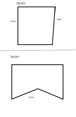

Thinking of surround options. Seeing as my woofers are 3" Fullrangers that can reach 10k Hz pretty easy I am not bothering with tweeters on the surrounds.
I have read what Bill and others have noted about surrounds and think I might have come up with a workable idea.
I have taken inspiration from XF Cab, Curved SLA and Wedgehorn. Roughly 2L Sealed Box for an Fs = 110Hz. Woofers cross-firing. Back of box is angled so that it can either be mounted high down firing to listening area or mounted medium high firing up into the roof. Gives me a chance to try both and see what I enjoy the most.
Doubling of drivers and 4 ohm wiring will give me approx 92-93dB SPL. Which should be more than enough. Cross-fire gives me wider dispersion and helps reduce combing.
I am trying to design these rather small and light so that I can use those stick on hooks as I live in a rental.
Any Ideas?
In other news I picked up a work bench for $4 and borrowed a selection of tools from friends and family. I need to pickup a cheap router and sander. Ordered my tweeters. Will order cross over components for LCR next week. Going to clean my garage this afternoon and setup a work area!

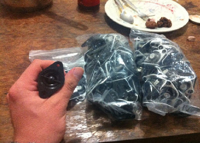

Tweeters arrived today. Expect my woofers early next week. I forsee a great deal of soldering in my future.
These tweeters have a little sponge on the back which is obviously used as a gasket. Hinting that these should be front mounted. I really want them rear mounted. Should I just screw them on and run some hot glue or silicon around them and over the screws?
Problem I am thinking of is that there will only be 6mm of wood between each tweeter hole. I can't exactly round that over very well. I guess all the tweet rounder overs would merge together through the center line.

BassMe wrote:Tweeters arrived today. Expect my woofers early next week. I forsee a great deal of soldering in my future.
The round-over would take most of the wood away. That might make it a bit tricky to do but doable if one goes light and easy (I think). Does your bit have a bearing?

Yeah the round over bit does. I'm using a 19mm think front baffle as well, so a 1/2" rounder over will leave a good solid bit at the bottom of the hole, and the tops will merge in the center.

And so the long part of line arrays begins. Anyone got a smarter idea for wiring these suckers?
Posts: 7634
Re: Home Audio Build. TLAH, SLA Curve, TTLS
#14 Post by Tom Smit »
Um, how about one loooooong wire, with insulation stripped at each tweeter terminal? :)

Thanks for the help today Tom.
I tried fiddling with that and couldn't get the wire to strip properly. Any hints?
When I strip the wire for the next section it pushes the plastic sheath along the wire covering the area I last exposed lol. I'll fiddle with it some more tomorrow. It is the more logical idea.
