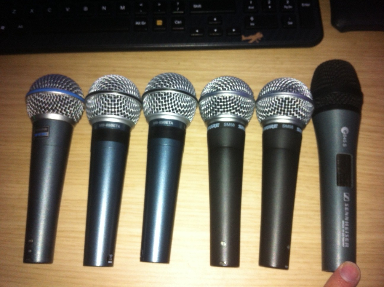

#11 Post by Chris_Allen »
This highly blurred image shows some of my mics:
Shure SM58 Beta (which decided to detach it's capsule and die)
T-Bone MB58 Beta (http://www.thomann.de/gb/the_tbone_mb85_beta.htm)
Shure SM58
Sennheiser E845
Of all those, I find T-Bone is the best all rounder but I use the Sennheiser as I find it suits my voice better.
I think Shure have lost their path and are still generating sales on what used to be a good, competitive product.
I wouldn't be afraid of buying cheaper copy products - the t-bones lasted longer and sound better (subjective) than the SM58Beta with more use and came with a better case at 1/4 the cost. I still use them now as the main microphones. The only issue I have is that some singers hear the brand name and believe it sounds better.
If I had to buy branded, I would always buy Sennheiser over Shure. I liked the 815, 835 and 845 but they are the only ones I've had. I've not had any real experience with EV mics.
