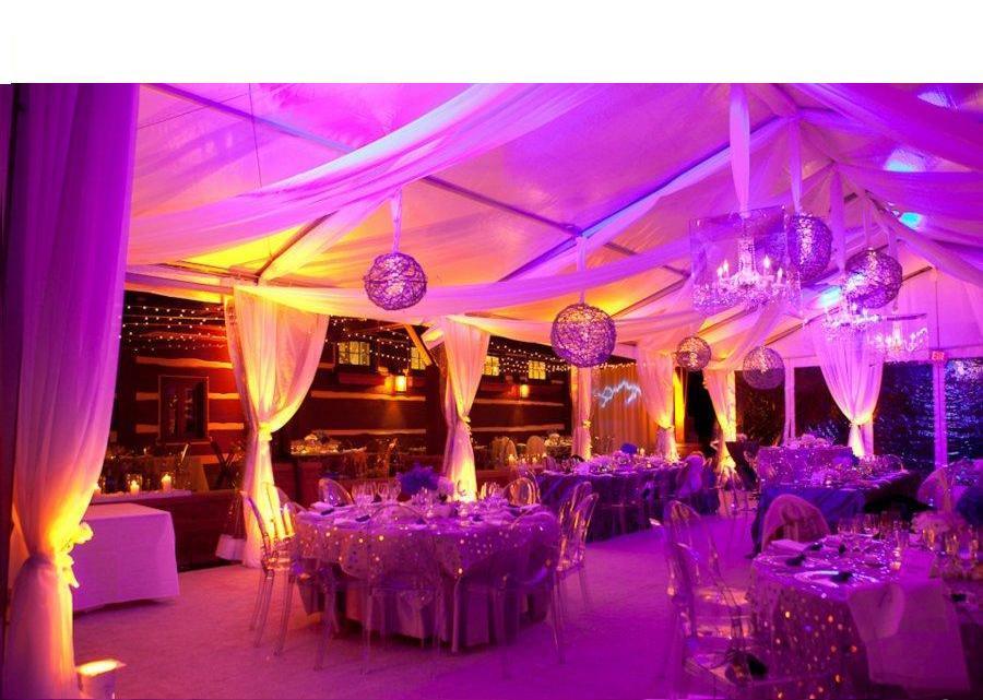

Depends entirely on the client's budget - if you go in and do things like this word will get around
