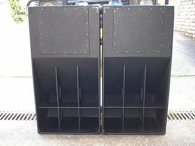

2 x 20" wide BP102 loaded T39's:

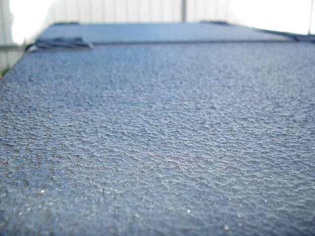

A nice textured finish with a combination of "Rockard" (Aussie cab paint) and an "Oldfields" fine grade texture roller:

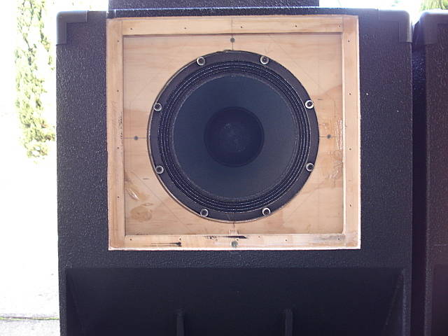

There are drivers inside:

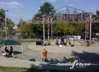

I just did one stage of an outdoor festival with two DR200's and two T39's, 3012LF loaded. It sounded really good and I got compliments. Part of it was being in an amphitheater, but the bass filled it right up. I had 10db headroom on the board (probably less in reality) but if the place had filled up with sound-absorbing people, it may have not have been enough to maintain that volume. Super-clear sound -- a musician said he was amazed how clearly he could hear each instrument. The rock band's kick drum could be felt in your chest (not crushingly but present) even at the top of the hill (where the picture was taken). My favorite part was mic'ing a Native American hand-held, mallet-hit, drum and cranking the bass from it -- really powerful.
