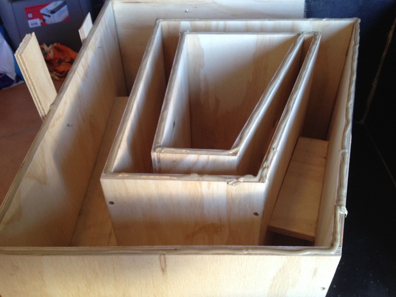

Im being very very careful to use enough PL.. I've gotten pretty good at laying down a very consistent bead of PL and get very nice squeeze outs.. Ill do some close-up pictures tomorrow! After doing quite a few cabs i've come to realise that PL really last a long way - its recommended to pour on a lot, but a small squeeze-out is just as good as a huge one.. Did a leak test with light in a completely dark room today and there was none.. Put the side on earlier and I always use twice the amount of PL on the side to make absolutely sure that ill get no leaks!

Exactly. After putting on the side i've found no leaks even though I only used a bit less than 1 tube of PL..

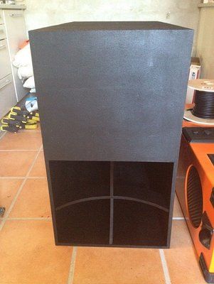

Here is a pictures of progress so far - been a busy weekend doing other things, so yesterday I gave it a few coats of Duratex - just plain coats no spatter or heavy orange peel.. Looks pretty darn good if I might say so myself!
Was thinking about putting it in the corner, but I just might lay it down and actually use it as a table with a glass plate on top of it..
