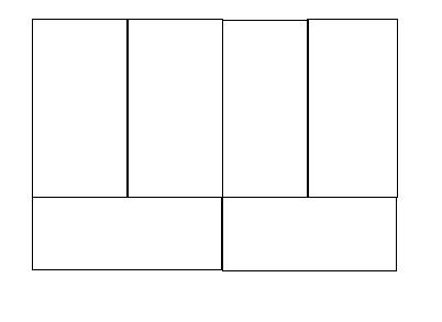

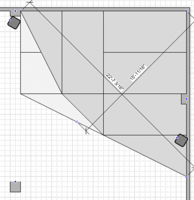

Should I paint the top with duratex? Lacquer it? Also, I'm trying to conform it to the corner of the barn, so I have a few different options. I'll figure out a way to tie all the pieces together underneath, and it will either be supported on cinder blocks or hay bales (as suggested above).
I'm trying to use as little space as possible, but it will be a cover band I play in (with a sub drummer):
-Drums -Keys -Bass -Sax -Fiddle -E. Guitar -Singer
so stages get a little crowded!
Here are the two options I am considering. The squared off one seems easier since it would be six pieces of plywood and only one diagonal cut.
