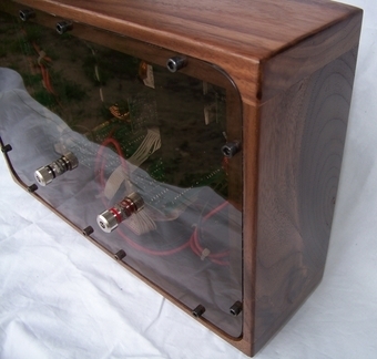

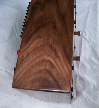

Just finished 2 of the 500 watt amps in oil rubbed walnut (not maple) and here's what I temped.. our road version with a steel grill in lieu of plexi runs just as cool. Both were the same:
Off- 80.1 deg
Idle- 82.3 deg
50% for 10 minutes (4ohm sealed 12")- 85.4
..Cooler than a polar bear's toenails.

#12 Post by bassmonster »
Beautiful work! Could be that the dual TT is about 3 ohms total impedance as well as to why the amp might get a little warmer when running. It hasn't died on me and nothing has melted or smoked yet so I think I'm okay. :cowboy:
