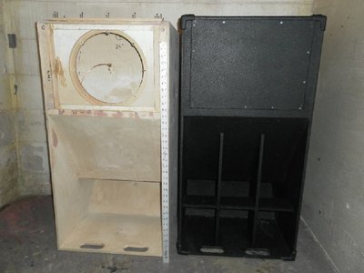

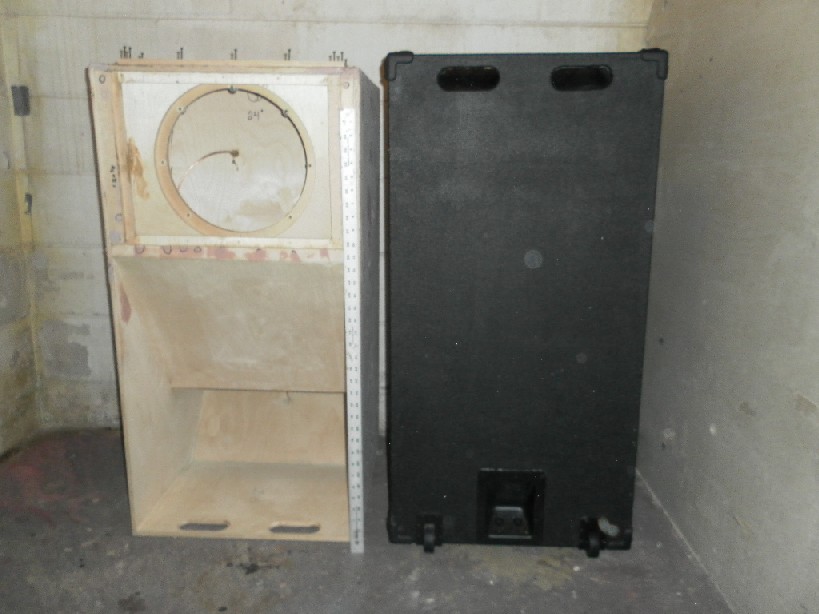

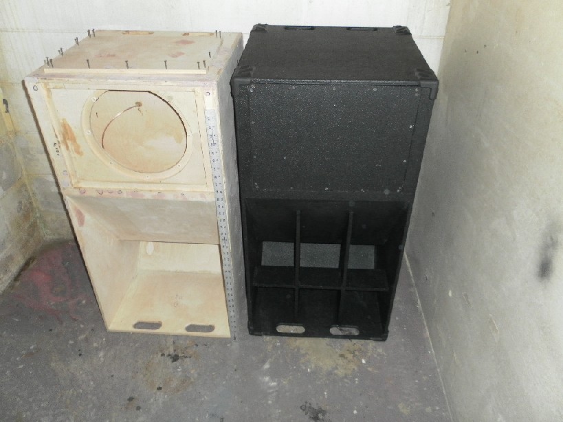

I finished 1 T-39,still need to sand,prime and paint the other one.I ran 25 volts into it and it sounded alright.......until i properly loaded it against a wall,a whole different beast.All parts from speaker hardware and of course Lelands service was excellent,i love ordering from him !!!

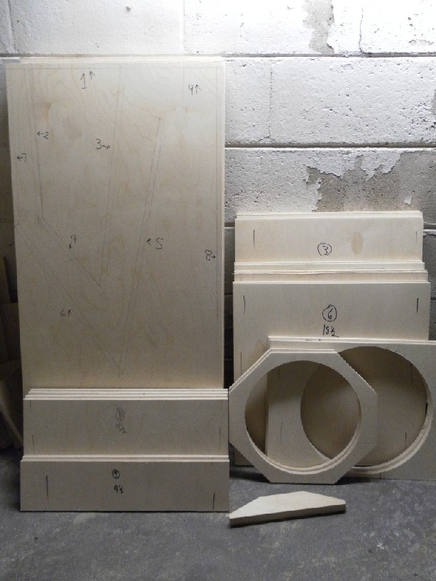

Sorry for not documenting step by step,i was trying to get finished with this project,i have had my fill of BFM for about 30 days.Before i built the T-39's,my wife had asked me if i could finish the SLA's before the superbowl,i was like maybe.but i had a sh@t eating grin on my face as i left her presence so i did get the center channel and the Table Tuba (17" wide,Dayton 10" woofer loaded).The T 39's are 20" wide.I think after i buy the other 3012 LF i'm gonna "need" some DR 200's for them
I did the whole build without wasting any wood.What helped me was i drew dotted lines along the width of all of my panels to remind me which side not to cut,worked out perfect.Scary moment,as i was bolting the driver in,i didnt drill the holes off axis so the uppermost and lowermost driver bolts were "hidden" but i was able to get to them,i think if i had to use 1 3/4 bolts i would have been in trouble.

Wasn't that front loading design for the Lab12 only? I don't have the plans handy, so can't check.

The T39 & T48 Plans have been updated.Chris_Allen wrote:Wasn't that front loading design for the Lab12 only? I don't have the plans handy, so can't check.

I believe what i used was the latest update of the T 39 plans.Thanks Doug,i will use that method.
