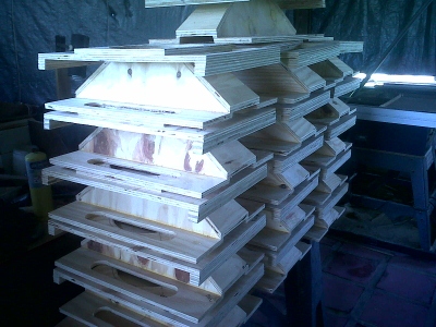

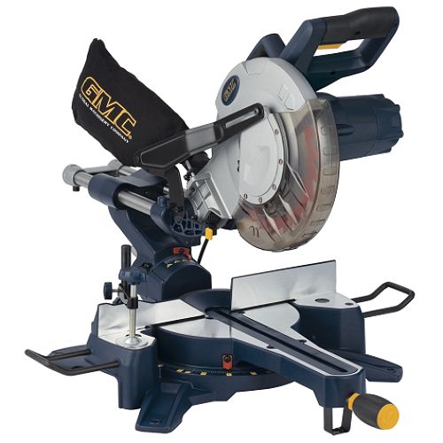

Got this one @ Sears for $160 and Im very happy with it.
Help me soooo much with my 16dr's built.
IMG00257-20110725-1412 (400x300).jpg (110.92 KiB) Viewed 3067 times
