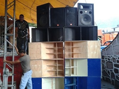

:cowboy: This is my first DR and probe at a party this saturday, sounds pretty good, but I think it could sound better if I knew the titan delays regarding the DR250 48 ....... anyone knows? :wall:

SONIDO TUMBAO wrote::cowboy: This is my first DR and probe at a party this saturday, sounds pretty good, but I think it could sound better if I knew the titan delays regarding the DR250 48 ....... anyone knows? :wall:
Bill says to delay the tops to the subs. Corner load them too, you'll get better results.

#8 Post by 67baja »
Yeah, I would definitely read the sub placement thread:
http://billfitzmaurice.info/forum/viewt ... f=10&t=398

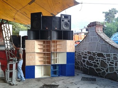

SYSTEM... :hyper:

Posts: 28982
Re: The system
SONIDO TUMBAO wrote:SYSTEM... :hyper:
Your top placement is a textbook example of how tops should not be placed. And this is the book:
http://www.gtaust.com/filter/05/07.shtml

#12 Post by SONIDO TUMBAO »
sr suggestions for this system. bill? Since not finished yet another DR250, I only made ​​1 .... there will certainly be noticed that no write or read English. :?:
Although he was badly off the Titans and lod HD215 and the media .... was heard a low awesome.

Re: The system
#15 Post by GirlyHandedDog »
SONIDO TUMBAO wrote:sr suggestions for this system. bill? Since not finished yet another DR250, I only made ​​1 .... there will certainly be noticed that no write or read English. :?:
It might be worthwhile to find someone that speaks english and spanish fluently to double-check your build and make sure you've followed the plans correctly. Unfortunately for those that don't read/speak English, there are a lot of nuances in the plans that if not followed will turn your 8 speaker build into a big stack of firewood. In particular, make sure you've got the Titans limited and high-passed correctly.
