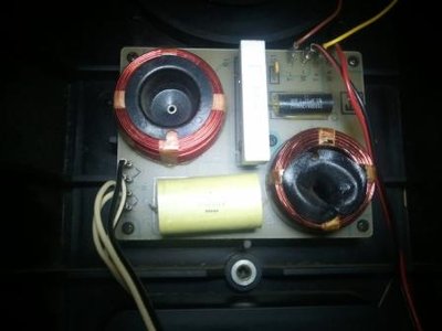

Just opened the cab and found this...
Do I need to replace the whole xover?
Re: Sound degradation
Whoa s that a cooked induction coil former I see before me?
to melt the former in a crossover you have to really put some power into them.
So new theory for the bad sound is a cooked voice coil, the insulation expands just enough to rub on the magnet.
run a frequency sweep to confirm. the Crossover may well be still okay but you may have to replace the drivers.

Thanks for all your help, one more thing what does the white rectangle looking thing do?

Its a resistor.jose99a wrote:Thanks for all your help, one more thing what does the white rectangle looking thing do?
Mr. Brent is a resistor used to protect the tweeter? I'm asking because 2 of the 5 speakers I bought have the resistor knocked off and I hear no difference from the other 2.

It could be a protection resistor, but I'm no expert in crossover design.
Are you sure the HF drivers are even working? It would be common in an environment like that for them to be blown. Removing the resistor and hearing no difference might mean you're simply hearing no HF at all.
Yes, the tweeters are working fine, thats why I'm puzzeled as to what are they for " protection or sound"
The speaker that has the "cooked induction coil former" as Mr. "horst" stated is the one that sounds bad "tweeter".
